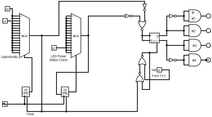

Anyone know what the chips are in this schematic?
looks like a CD4067B times 2 (for redundancy) but what the chips do is take voltage of 5 vdc on or off on 16 channels and provide a variable duty cycle square wave output to the M, M1, M2 outputs and to other parts of the schematic/ other boards.
when LED pickup circuit sends a 5 volt signal to input #1 from a photosensor the circuit sends a narrow pulse width signal to the output, such as 10%...if the 5 volts then goes to pin 2 then the pulse gets a bit wider and so on until at input pin 16, there is a 90% duty cycle square wave. I dont think it ever goes from 0 to 100 or if so i could just use inputs 2 thru 15 and keep 1 and 16 unused to prevent an off or fully on condition.
there is an adjustable frequency square wave clock input at point G
Im not sure if A3 and A5 are a HCF 4089b chip ??
anyone out there know ?

A1 and A2 appear to be 16-channel multiplexers. They scan the 16-LED detector array to determine which are illuminated and which are dark. Each dark detector generates a HI signal which appears at the mux output when that channel is scanned.
The 4-bit address sequence for the scan is generated by A3 and A4 (likely 4-bit binary counters, not a 4089b which is a binary rate multiplier.)
Not sure what A4 and A6 are but would appear to be flip-flops. The signal from the mux apparently controls the A6 FF output on each scan sample.
Appreciate the reply, but how do we end up with a variable width pulse???
The number of output pulses from the mux is proportional to the number of detectors illuminated. Thus the time that the FF is set or reset during a scan is proportional to the number of these pulses, giving a variable pulse width per scan.

I'm not sure I completely understand you questions and requirements, but I'll give it a shot.
Google multiplexer if you don't understand their purpose or operation. They do not respond to a signal, only transfer the signal from the selected channel input to the single output. The 4-bit counter causes the mux to sequentially scan all 16 channels.
If you want a variable pulse output based upon which LED is lit then you could scan the LED detectors with the mux using a fixed frequency clock. When the mux outputs the channel signal from the blocked detector, you use that to set the flip-flop. At the end of the scan you reset the flip-flop. Then restart the scan sequence. That will give you a pulse width from the flip-flop that will vary with the position of the detector in the scan sequence (It will be set from the time the blocked detector is scanned until the end of the scan sequence).
A DAC is a digital to analog converter. Don't see any need for an analog signal in your application.
You mention a variable frequency PWM signal. Usually you do one or the other but not both. PWM is usually fixed frequency.
You may need to do some type of state diagram to fully describe your requirements. Your verbal description is somewhat ambiguous.

here is a diagram of a simulation i was able to put together...I know that A1 and A2 are Mux chips cd 4097b.
one takes a single moving logic high and outputs that high signal every time the counter gets to that address. If the logic signal moves farther up, the address goes farther up . The output is used as the clear signal also for the counters???
I cant seem to get a variable width pulse from this setup. All i get at the 4 outputs is a fast or slow 50% duty cycle... and i still cant figure out the tawo NOR inverted signals coming out of the counters and going to chip A4 in Figure 2
Anyone care to help with this one
The end result must be
1. no action if the LEDs lose power (A2, fail safe) (done)
2. variable width pulse at the output per given frequency or period...
3. figure out what is happening with A7, A8, A9 and A4???
attached diagram and Logicsim schematic
