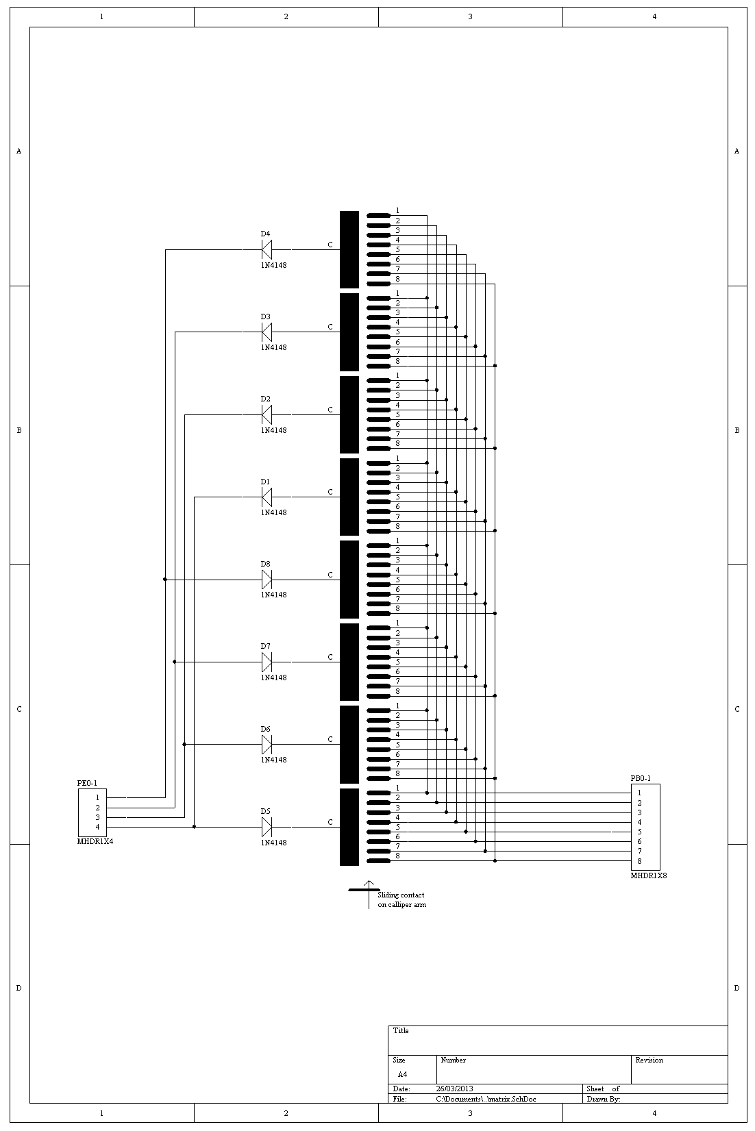

John, the board is simply a pair of switch matrices separated using the diodes; see post #51 for schematic.
It can be used in the same way as a standard switch matrix, except that attention has to be paid to whether a column or row is driven low as this will affect which matrix is read. See post #61 for code to read the matrix.

I saw post #51 and with due respect, I couldn't figure it out. I think I know what you intend from a high level, but not a single connection is shown.
I am used to working with Eagle and that design (post #51) would not lead to creation of a meaningful board design. If you looked at my critical pathway chart, you should realize that I consider the actual switch design a bit of a diversion at this time. Nevertheless, I can appreciate Vivian's desire to get it resolved and see it as no big deal doing that with a little additional information. At the very least, it will allow for real results during simulation -- at least if she uses Assembly, which I don't think she will. I don't know how C simulators work.
John
If you didn't understand it, then I obviously need to work on my delivery. I tried to state that each intersection in the matrix shown in the drawing should have a switch; that is, every time a row wire crosses a column wire (in the diagram), it should be assumed that there is a switch there (between the row and column). I have seen switch matrices drawn in this manner on different occasions. The switch is 'turned on' when the wiper bridges the gap between the row and the column contacts on the PCB. I might redraw it some time.

Ok, here's the schematic for the switch matrix again. Hopefully it makes sense. PB0-1 may have connections reversed, though this can be corrected in the code very simply.

I agree that is probably right based on available information in Vivian's post #32, now that you have fixed the diodes for the upper level and lower level ranges (e.g., the pair of diodes shown connected by the magenta line are segments 3, 7, not adjacent segments).
A few additional tests by Vivian should confirm it. Since it is at least a double-sided board, I usually confirm electronically where I think connections go, even though they may appear to be connected a certain way.
Sorry, not sure what you're referring to.
Now I'm using Proteus ISIS 7 Professional software to draw and test my circuit design. Do you know how to draw the fat matrix using the Proteus?
I haven't used Proteus in years, nor do I have a copy ATM. From what I remember it was very straight forward to use. If I were to simulate the matrix I would probably use two rotary switches to select the appropriate row and column together, or failing that, I'd use two sets if eight switches to do the same; beats placing 256 switches.

This is the circuit that I draw, can anyone check is my circuit design is correct. For the fat matrix, I assume there consists a lot of push-up button, so when the slider is slide, and stop at one of the button, then the button will be pressed, and from there the thickness of the skin can be known.
Thanks :eek:
Vivian
The resistors for the LEDs should be between the PIC outputs and the LEDs (not connected to Vcc).
As mentioned prior, the LEDs and extra switches can be added to the matrix using an extra pin.
You haven't connected your LCD.
Otherwise, at a glance, it looks good.

I have question about the fat matrix. So assume now the PEO-1 (4 input) want to scan the column of the scale, how is it functioning? And the function of the 8 diode which connected with the PEO-1. I know diode's function is only allowed current flow from one direction. But I still can't figure out what is the function of diode in this fat matrix.
