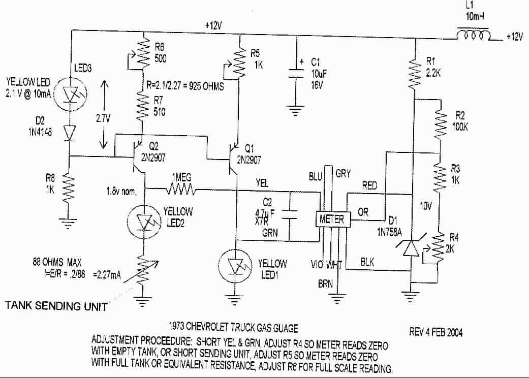

id like to make a digital fuel guage for my car that shows the fuel as a percentage using a LED display
i do know a bit about electronics i can solder and know the names/functions of most components
whats the best way of going about this?
I built one for my truck using a 200 mV digital meter (LCD). I did not use enough filtering, so gas slopping in the tank makes the reading change rapidly. I will hunt up the schematic, add some filtering and post it here. The meter I used was Lascar EMV 1125.
