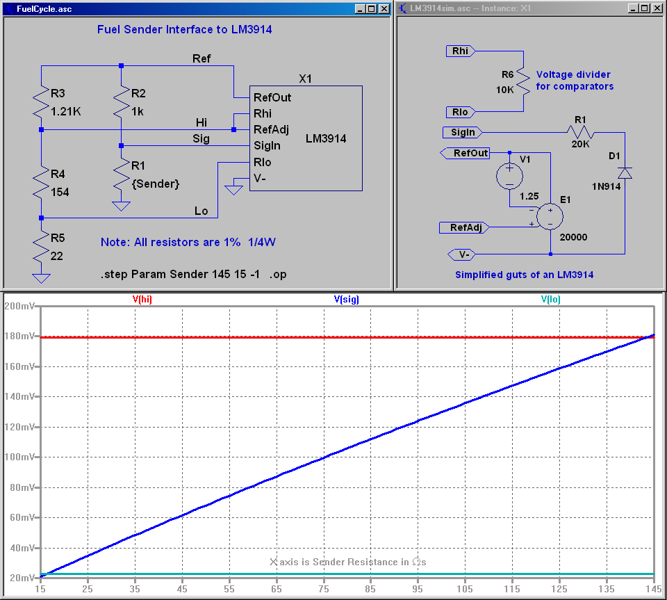

Here is a hack that progressively lights LEDs on a LM3914 as the sender resistance goes from 15Ω to 145Ω. Unfortunately you probably want it to go the other way because you want all the LEDs lit when the tank is full, not empty. This is a partial schematic only; you will have to look up the data sheet for the LM3914 and hook up the other pins as shown there.
I use the LM3914's internal voltage regulator to create a bridge where the internal comparator voltage divider's Rhi and Rlo are connected to voltages that just straddle the range of Sig. Look at the plot and see how V(sig) ranges from slightly below V(lo) to slightly above V(hi) as the sender resistance changes. The current out of the RefOut pin sets the LED brightness. With these resistor values, the LED current will be about 20mA
To invert the way the LEDs light, it will require the addition of an opamp, or if the sender has two isolated connections (meaning that one end of the sender in not intrinsically grounded to the gas tank), it might be possible to flip the bridge circuitry upside down and do it without adding the opamp?
Please advise.

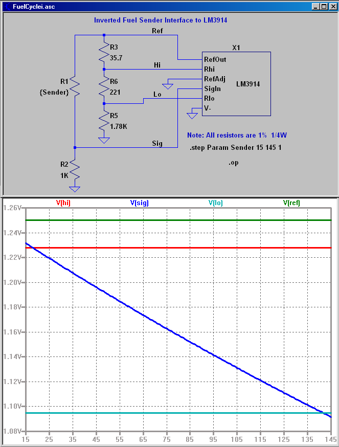

This is the inverted version which will work if both ends of the sender are isolated from the grounded fuel tank.

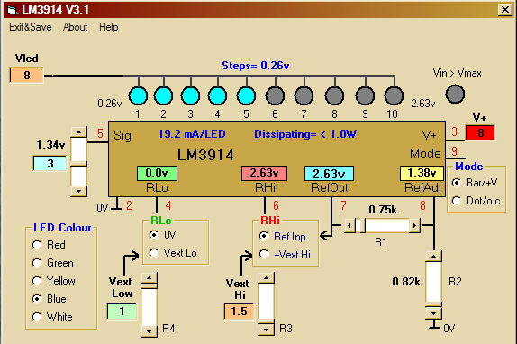

Eric, sounds like another job for your cool LM3915 program...:)
hi bb,
Look at this circuit as an option, the LM3914 image shows a half full tank.

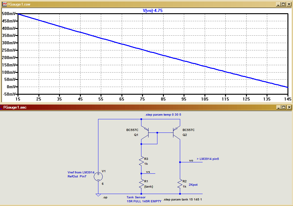

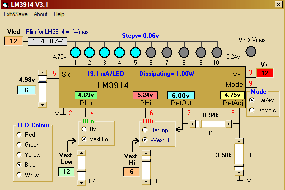

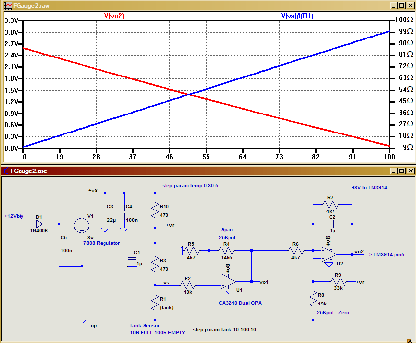

hi bb,
Look at the images for this option.
The CA3240 or equivalent specification, is a OPA is a 8 pin dual.
The 7808 is a standard voltage regulator, its needed because of the changes in the cycle battery voltage line.
The plot shows that its linear within 1 or 2%

hi eric,
What you did is amazing and I can't wait to try it out. I just want to clarify a few points on the schematic.
1. Can I use the TL072 Dual-OpA? I have a bunch lying around as I am also DIYing guitar gadgets.
2. Should the +vr be connected to the regulated output of the 7808 which is 8v?
3. V1 is the 7808, U1 is the CA3240 then what is U2?
4. Does the Vo1 (the cut line part) points to nowhere?
5. Are the R4 and R8 variable resistors? Can I use trim pots using only its 2 pins?

hi eric,
No, connect as shown to the junction of the two 470R's
U1 and U2 are the two parts of the same DUAL opa package
The vo1 line is for SIM only
Yes, they are variable resistors, connect the centre pole [wiper] to one end of the pot with a wire link.

Hi eric,
I have built your awesome schematic except that CA3240 isn't available locally in my area. Do you have any alternatives to these Dual OPA? This is the only remaining problem and everything's good to go.
I will post results after everything has been tested to help other forumers.
Biboy
Hi eric,
Biboy
Can you buy say LM358, TC358, if not what can you get.?
