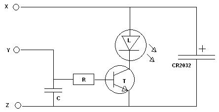

Ok, I'll show my lack of experience here....
Can the circuit (diagram attached) be coerced to do what I want?
To turn on, momentarily short X and Y
To turn off, momentarily short Y and Z
If not turned off, choose R and C such that T turns off after, say 30 minutes
'momentarily short' could be implemented with reed switches or, more crudely just exposing a couple of contacts and shorting them with a paperclip :)
Am I getting this all wrong?

With a logic-level MOSFET (instead of a transistor) and two 3V
batteries in series (6V) and a large capacitor and a high value
resistor in parallel with the cap, you could get a push-on/fade-off
circuit...no push/on-push-off. And I don't think you would get
anywhere near 30 minutes though...but, maybe without the parallel
resistor.
Ken
In theory it would, but C would have to be very large to stay on for 30 minutes. Say the LEDs took 10mA. Using a gain of 20 would give base current of 0.5mA. This would require an R of 2kΩ for 0.5mA and a 1V drop. A 30s time constant would require a capacitor size of 30/2k = 15mF or 15,000µF.
Also as the capacitor discharges, the LED would get dimmer and dimmer, until it finally extinguishes.
It also requires two switches. You originally stated you wanted one.
Ok, I see where my naiveté is - C will be HUGE.
And, yes, my later solution introduced a second 'switch' - I'm thinking and typing at the same time - apologies!
I see now why the flip-flop solution is so elegant - I have drawn the attached schematic of what was described to help me understand.
I 'borrowed' the circuit from elsewhere so I'm guessing the 0.1 capacitor is 0,1uF?
I guess the current drain input R requires is not too great but to get my 30 minutes delay I'll still need quite a large R1 and C1
(I'm thinking 10Mohm and 150uF - but I'm not too sure if these are realistic or if C1 would be physically too big)
So any recommendations on R1 and C1 (and D1 and T1) would be appreciated.
Maybe the timer part is just too much.
You'll all be glad to know (or at least not totally surprised) that I'm getting the feeling I am seriously over-egging this and just put up with the switch :)
(or at least not bother with the timer element)

The 0.1 cap is 0.1µF.
Your circuit looks ok but you should add a small resistor in series with the LED to limit its current. If you build it, be sure to tie all unused inputs of the FF package to ground.
The circuit may be a little marginal with one battery and you may find you need two in series.
D1 and T1 can be just about any small signal diode and transistor.
Yes, 30 minutes is a very long time to do with an RC circuit. The leakage current of a large electrolytic capacitor can be a problem, which would make 10MΩ problematic as a charging resistor. Typically for such long periods you use a low frequency RC oscillator driving a digital counter. For example the 4060 has circuitry at the input to build the oscillator along with a 14-bit counter for long delays.
