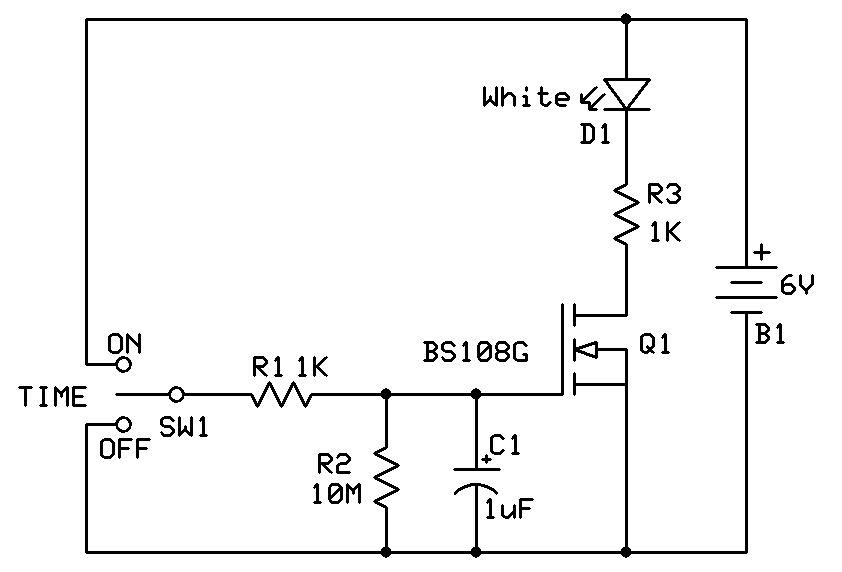

Sadly, the 'spec' from my daughter was that the lights be transferable from house to house.
I offered to wire each house but she was adamant - naturally i wanted to wire it and have rechargeable batteries hidden away - the thought of paying for numerous cr2032's does not fill me with joy.

A quick bread-boarded experiment with the component values shown.
Push-ON/Fade-OFF after 30 seconds, as the voltage across C1 drops below 1V.
Increasing the values of C1 and/or R2 should proportionally increase the On-time.
The leakage current of a large electrolytic for C1 will have a limiting effect.
SW1, SPDT/Center-OFF, gives Push-ON/Timed-OFF/Push-OFF. I can't seem get around that with this "simple" circuit.
