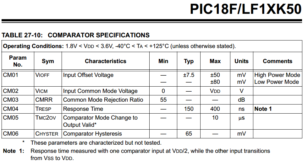

Sooner or later, I'm planing to recreate *THIS* LC meter, and make some improvements to it. I was wondering if anyone had any opinions on it and some of the modifications I plan to do to it. My objective is to get a good RF LC meter so I can start getting into minor radio circuits and hopefully broaden my sphere of knowledge. And also have fun.
The main thing I want to do is increase the free running oscillators frequency. I figure I want to do this because, someone somewhere said that it is best to measure an inductor or capacitor at the frequency you plan to use it at. And that persons reasoning seemed valid. As I understand it, they basically said inductors and capacitors have different effective values at different frequency's do to combined stray components and what have you. So, measuring it at one frequency may give you a completely different reading than what it actually is going to effectively be on another.
I also plan on using a different model PIC μC, the PIC18F13K50. I chose it because I own some already, it is small, fast, it has a hardware multiplier, and has an internal comparator. If I am interpreting the datasheet correctly, the comparator is guaranteed to run at ~2.5 Mhz, but typically it can get to ~6.6Mhz. Here is the relevant table I figure this from...
[SUB]1/T[SUB]RESP[/SUB] (response time) in seconds[/SUB]

I am going to have to do this no matter what. Unfortunately, the internal comp of the 13K50 can't be set to route it's output both to a pin, and to internal capturing mechanisms at the same time. The only way to use the comp as the oscillator, and get it's output back into the chip, is to expose all the comps pins externally, attach it to all the passives, and then rout it's output pin to the input pin for the CCP/timer1. And sadly, the internal comp can only run at ~2.5 Mhz, so this configuration can't ever get up to VHF frequencies.
I would rather make the measuring oscillator run in VHF/UHF, as ISM bands in that area are about what I expect to use the measured caps/coils for. But I am conflicted because I also don't want to deal with HF board layout issues on this project, or add more parts to the design. But if commercial meters measure at low frequencies, and the measured parts are accurate for VHF/UHF, then I think that 2.5Mhz will probably be fine.

I guess I sorta lied about the inner workings of the 13K50's comparator. . . :)/)
It is in fact possible to get it's output to a pin and to the internal data bus simultaneously. What you can not do is internally direct it's output to increment/de-increment Timer0/1/2/3, the ECCP, or any other peripheral. Which is really quite a bummer when what you want to do is high speed counting and measuring like I do. The only way to do things entirely internal to the PIC is to use the comparators interrupt flag and have the interrupt handler deal with things manually. I would rather take the extra pin hit and make use of a peripheral, as interrupting main program operation at a 2.5Mhz rate with a 12Mhz system clock is pretty much impossible.
The whole mess is a fairly obscure problem really. There are only five places the outputs of the comparators go.
(1)The data bus.
(2)The comp interrupt
(3)The comp output pin
(4)The very specific SYNCCOUT
(5)The non-descript "to PWM logic"
(1)The first can only be accessed manually by setting RD_CM1CON0 and reading the bus.
(2)The second should be self explanatory... it is the interrupt.
(3)The third is of course external to the PIC, and thus invalid.
(4)The fourth only goes to the internal SR latch inputs, where the use is very specific.
(5)The interesting one, the non-descript line "to PWM logic" would seem to indicate that the output does in fact go to the ECCP, and it does. But close examination of the ECCP shows that it is intended only for the Auto-Shutdown feature, it doesn't work as an input for the capture mode. It really should be called "PWM Auto-Shutdown flag", or something like that since that's the only damn thing it can do.
It's kinda funny, if I had the PIC's schematic, I could probably add just a handful of logic gates to give it the functionality I need. It's a trivial difference in circuitry for a modest gain in functionality IMO.
