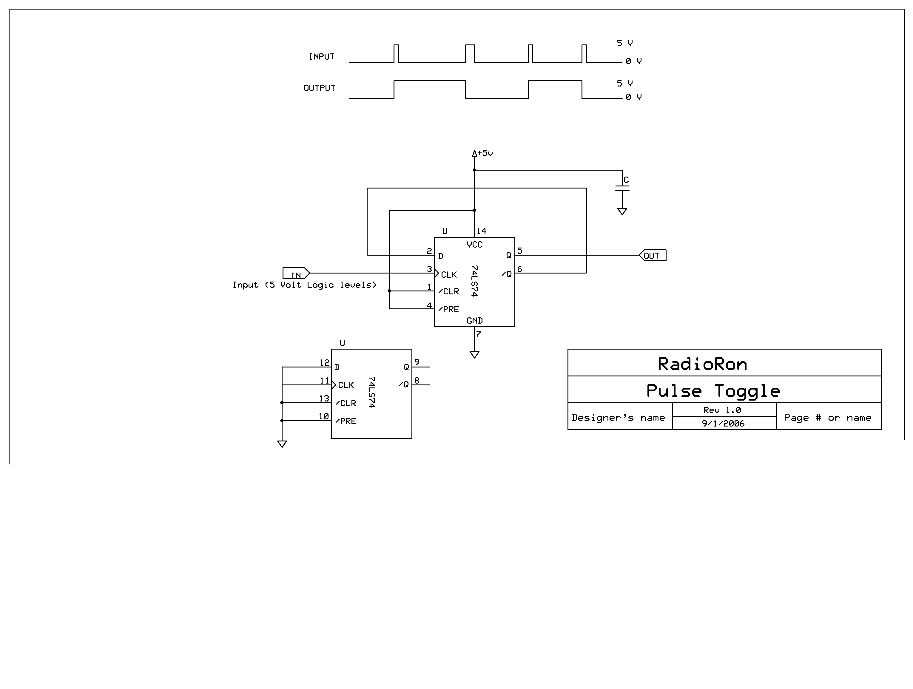

No. a curcuit that will switch from 0 to 1 when given pulse and with another one from 1 to 0, and so on.
What you need is a toggle flip-flop. Take a 74xx74 dual D-flip flop. Connect the Q-bar output to the D input. Tie Preset-bar and Clear-bar high. Run your input to the clock. On each rising edge of the clock, the output will go to the opposite state. It will toggle. For the other flip-flop in the package, tie all the inputs high.

You get a 74LS74 digital IC and hook it up as in this diagram
