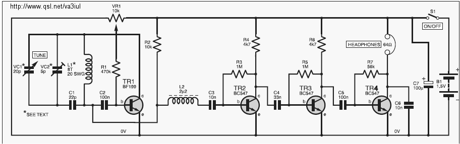

i have been working on a wireless transmitter and receiver for a bigger project of mine, but i'm affraid that there is too much analog interference, so i want to switch to digital, but i don't know how. Google has been no help to me at all. Any help would ne greatly apprecheated. this is the website i got the TX and RX form: YO3DAC - Homebrew RF Circuit Design Ideas

i am not looking for a radio that requires software. my circuit is for wireless headphones. the circuit that i was using is attached. i only modified the values for 15MHz and 20MHz (one for each headphone). all i did was modify the values for a simple FM transmitter circuit, the problem that I'm worried about is interference, if i switch to digital, then i need not worry. and range is not an issue, ideal a maximum of 10ft.
Using a digital signal will not solve the analog noise problems, the noise will still be there it doesn't just magically go away when you use a digital signal. What exactly are your project requirements? You may be able to find a commercial product which meets your needs.
