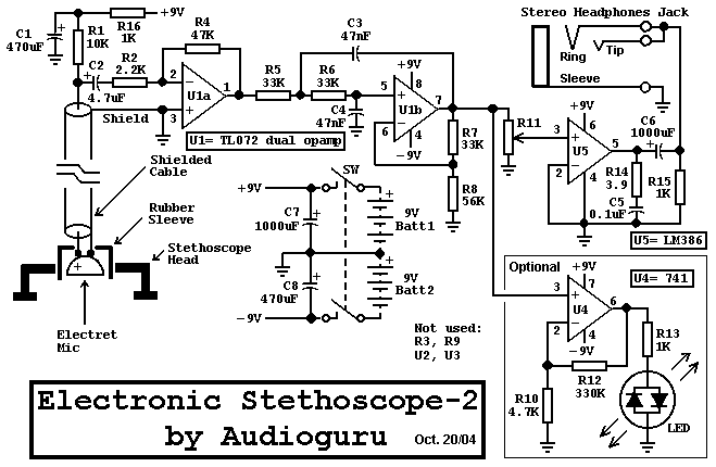

hey,
m biomedical student..3rd year!
i have to make DIGITAL STETHOSCOPE, do any one of u can help me..
i have its CIRCUIT diagram,but not sure bout that what should be the changes in it..
so kindly HELp me..
hope u people will..

No,
this is Electronic Stethoscope..
but i wanna know how do i make it Digital..?
and if i only work on it..so whats should b the changes to make it work perfectly!
So what do you want the Digital Stethosope to do? What indicators, etc.?
I suppose you could digitize the mic input with an ADC, display the waveform and convert it back to analog with a DAC but that seems rather silly. I think this is a case where analog is just fine.
Maybe the OP isn't telling us everything.
The OP doesn't know what his teacher wants to be digital. He should ask his teacher if the pulse rate per minute should be on a digital readout. Maybe the waveform of the heartbeat should be shown on a screen.
It would seem that there is no way around the sensing portion being analog. IMHO Pure digital would be out of the question.

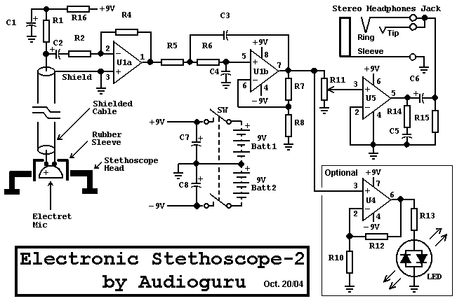

Hi audioguru,
why didn't you put in part values?
Hans

My project has the parts values in the schematic.
