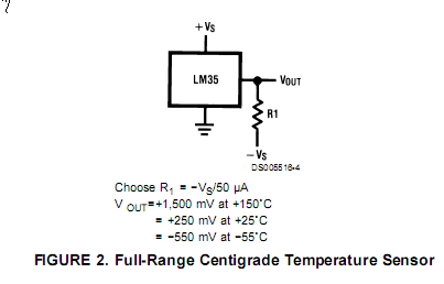

Hey I'm trying to build a digital temperature sensor with a lm35 in the ranges -15'C to 45'C. The lm35 has ranges from -55'C to 150'C and is 10mV/C.
I'm connecting the sensor to a CA3162 and a CA3161 then to 3 LED displays. The CA3162 has a input range of -99mV to 999mV, while the lm35 has an output of -550mV to 1500mV.
I want to use a 5 volt supply and not with a +-5V supply.( on the lm35 datasheet theres a figure to use single supply. How do i connect the sensor to the lm35 ? do i need to use tension dividers or do i connect it directly to the to HI & LO of CA3162? and do i need to put a bypass filter on the sensor?

The CA3162 will only go to -99mV so you would have to use a 10:1 voltage divider (two resistors of 18kΩ and 2kΩ) at its input if you wanted a direct readout in degrees C (-15mV to +45mV), thus you would only have a two digit readout. Is that acceptable?
If so, you should be able to connect the CA3162 input through the 10:1 divider, to Vo as shown in Figure 7 in the LM35 data sheet.

Using the double diode and 18K circuit shown in the datasheet for the LM35 you get -55 thru 150degC.
Its possible to use one diode and a 9K[ two 18K in ||] to give a range of
-27.5 thru +150degC.
The outputs are the same as the two diode version, that is from the LM35 output pin and the LM35 pin that goes to the diode.

A wire length of upto 1mtr will not be a problem with a LM35,
I would just twist the two signal wires together in order to reduce any pick up.
Using the two diode version will be OK over the limited range of -15C thru +45C.
As you know thats a 'change' of 60Cdeg at 10mV/C ie: 600mV

Do you have the datasheet for the LM35.?
Look at this extract from the data:
Look at the current/resistor values for the two diode version and adjust the values to suit one diode.

YEs i have seen it in the datasheet. Well to me according to your calcualtions, the range would stay the same from -55C to 150C just with one diode. How did u get the -27.5C?
