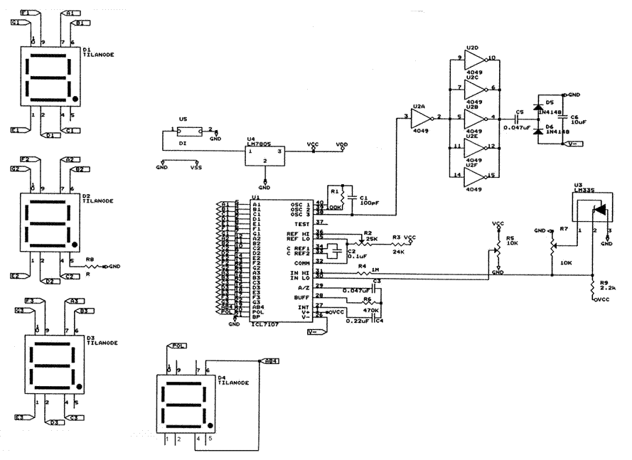

I want to build a digital thermometer with a 3 1/2 seg. LCD Display and IC 7106 included. can i have a circuit diagram please
Hi mankunnam :)
I found these for you. Hope this will help
htt://xoomer.virgilion.it/fladelle/Page11.htm
Here is a schematic that uses IC 7107. You can use it with IC 7106 also if you want a LCD display instead of LED displays.

A Fahrenheit thermometer is easy to build. Use a centigrade sensor
(like LM35, 10mV/°C) and multiply it's output by 0,18 with a resistive attenuator (e.g. 82k & 18k). Short the "hi" input of the 7107 and apply
-32 mV to the "lo" input so that the reading is 32,0. Remove the short
from the "hi" input and apply the signal from the attenuator.
You don't have to be a rocket scientist to do that.
