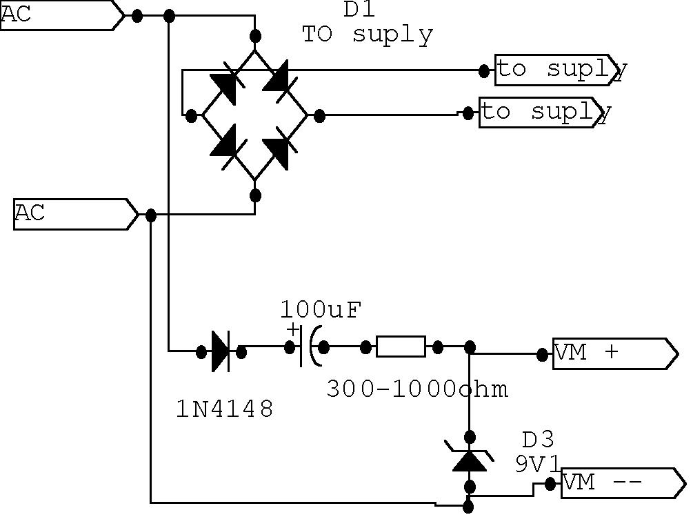

Hello I have made a power supply and I want to put on the digital panel meter that I have. The problem is that the meter cannot measure the same voltage that it is being powered by. Or even a voltage form the same supply. I can power it with a separate source such as a 9 v battery and it works fine but I don't want batteries in my power supply. Does anyone have any ides how to isolate the think or how to change it so that it can measure form the same source that powers it. Or does anyone know of a small digital panel meter that can measure it own voltage that is cheap like under 20 dollars.

well, if u still heve the meter....
does the power suply have some ac current? and then the ac is rectified and regulatend and so on...?
if u have ac, try to use a capacitor, a diode to form an auxiliary suply, considering that the VM doesnt consume much.....
if it does, try to use 2 larger capacitors and a full wawe rectifier....

I don't think the supply suggested by bogdanfirst will provide the isolation you require...
There are DC-DC converters that can do what you want ...
**broken link removed** - look for the TMA/TME range, I have used these things before, they are good :D
**broken link removed** is an alternative (same idea)

i had buit a power suply and used some voltmeter like you said....and i used something like i said, but because it was an old type of VM, it used around 100mA(it had 4 digit display with leds), so i used a full recifing bridge, and 2 capacitors, not just one......and it worked...maybe u have some other type of VM?
anyway u could use thae same kinf of idea to generata symetrical voltages from a single suply....

If Your VM chip is 7107 You can apply a simmetrical + - 5V supply.This method enabled make common GND.See datasheet on Intersil-Harris site.
