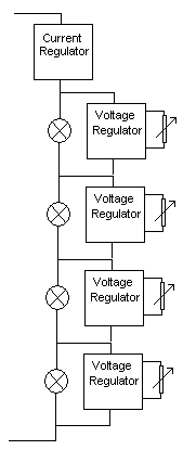

I have two theories on how to achieve this...
If each lamp had a voltage regulator in parallel with it then it could be dimmed by reducing the regulator's setting. A complication here is that there must be a current limiter in series with the lot whose main purpose is to 'waste' the excess voltage, this makes the whole rig run at a constant (maximum) current even when everything is at minimum brightness. The lamps will never really see zero volts as some voltage drop will be required across the regulator circuit to power it.

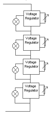

If each bulb is connected to a three-wire regulator such that as the regulator is 'dimmed' the bulb effectively taps off lower voltages from its regulator (like a rheostat, common, wiper-to-bulb, track-top, sort of thing). The circuit will then (hopefully) not require the current limiter circuit mentioned in idea 1. It could be possible to go right down to zero volts with this but I suspect the circuit will end up more complicated in this configuration.
NOTE -- Both options will generate a fair amount of heat as each of the seven circuits will dissipate some 50W (a total of 350W).

ok, related to figure thaory_2 i think that i might have an idea. if you can put a variable resistor in series with thel bulb and one in paralel with the bulb and the series resistor, and mecanicly connect the variable resistors so that when the series increases and so the lamp looses intensity and the paralel will descrease so that the whole circuit will have a constant resistance and will not affect the other lamps.
here is a figure of my idea, but the resistors can be replaced by a simple transistor circuit wich will make it better.
