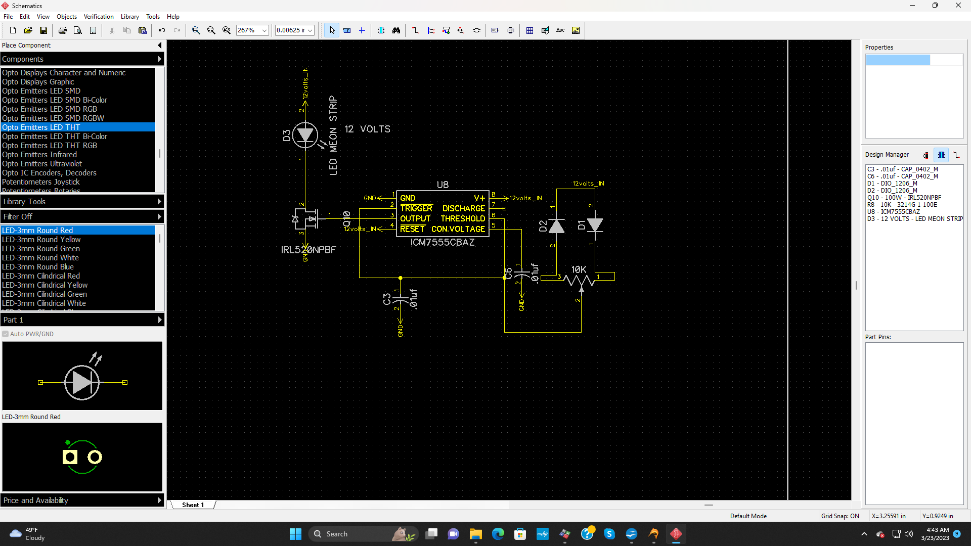

ran across this schematic and thinking of incorporating into my next sign PCB.
QUESTION maybe a 1K resistor before the gate to protect the gate?

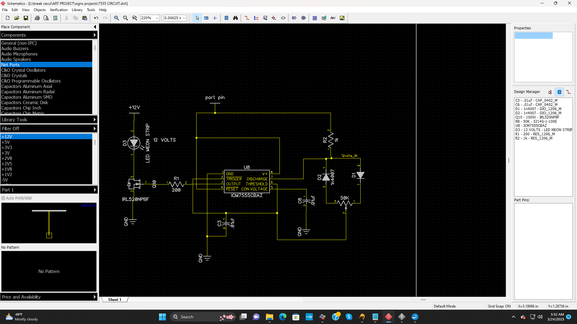

The uC is controlling the automation of the proposed LED Neon sign I am looking to build. My first one for my town's centennial came out good but these LED Neon rope lights are really bright and thus have a dimming circuit.
I got to thinking about versatility thus why not add a dimming circuitry to 8 of the ports on the 18f2221 using 7555's.
The uC can still do its thing but being able to dim sections of the sign would IMO make a better-appearing sign.

Adding 8 copies of that is a lot of hardware to add when you've got a micro that could do the same thing with just a FET and some code, but then again you'd have to be able to write the code, so...
As I said, whatever floats your boat.
yes, I agree with you BUT reprogramming the pic to get the desired dimming effect for each LED strip is a concern.
I considered several options.
Need to look at whether to have the port pin supply the Vcc to the 7555 or use the 12v input that powers the LED strips.
As for hardware, 2-1n4148 diodes, 1- pot, 2- caps.
This part would give you 16 channels of PWM with just the two I2C pins from the uC. PCA9685
If you want pots to control the PWM value, just run the pots into ADC pins on the uC. Read those and send the values out to the PWM registers.

Don't you want all strips to be the same brightness? Doesn't sound like you need to constantly vary them. Use 1 PWM output, 1 FET and set the brightness of each strip by altering the series resistor.

My present sign I built has 8 MOSFETs to control the 8 different LED strips but I want to vary the brightness on several different channels. I have a short bit of code but it is not PWM. It varies the time the port pin is on. I need to reconnect the pickit, connect the computer, then plug in the 12 v supply. Load the reconfigured code and test.
If I have a dimming circuit for each of the 8 ports then I can adjust "on the fly".
Just thought it would make a better design.
this is what I am considering so each port has a dimmer circuit
the 7555 draws 300ua, well under the 20ma per port pin.
now to locate a 555 so I can experiment with it. Waiting for the 7555 from Ebay.
