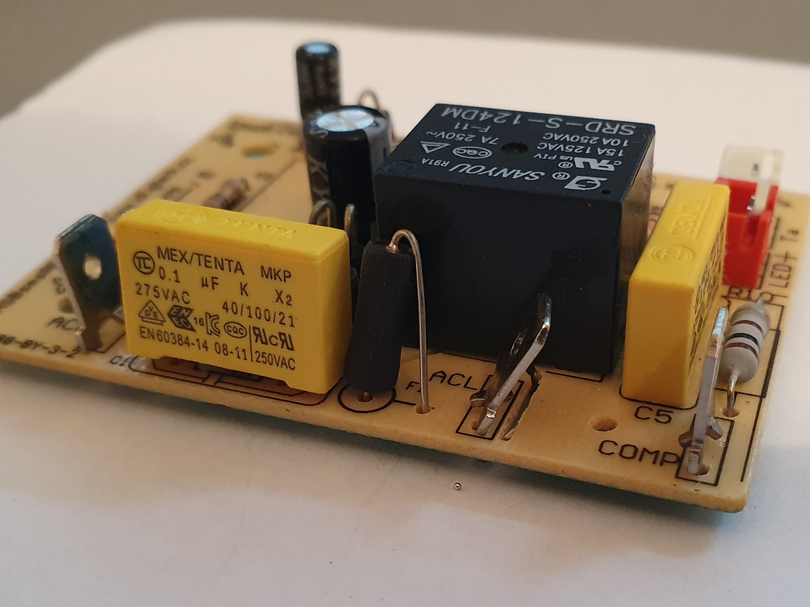

Hi Les,
Thanks for the reply and for the link for the resistor. Do you think this will work ok even they look slightly different?
Also, you suggested testing the capacitor. Should I text all 3 of them?
Perhaps I need to test other components also or is it worth just buying that resistor, putting it in and seeing if it solves the issue?

I think that fusible resistor should work. (The picture an Farnell's web page shows a different value resistor to a 47 ohm one. It is just to give an idea of the style of the resistor.) It is worth spending a few seconds checking that the 1 uf capacitor is not short circuit. There is also a varistor on the board that connects between the output side of the 47 ohm resistor and what I think is probably mains neutral. You have not shown us what the other connections on the board are connected to. The only one we can make a good guess about is the mains live input connection. It is also worth checking that this varistor is not short circuit. I only traced the circuit far enough to confirm it was a typical transformer less power supply. It is unlikely that anything after the bridge could cause the resistor to fail. Even if the bridge rectifier failed short circuit the 1 uf capacitor would have a reactance of about 3.3 k ohms. (Assuming 50 hz mains) Even if your mains voltage is 240 volts the current would be limited to about 73 mA.

While Les may be right, the example he links to is not the same "size". His link is to a 2W type, 10mm long. Your resistor/fuse is almost 15-16mm long based on your picture. That puts it into the 3W class of device. There may be 2W versions this size, but shop carefully.
EDIT: Digikey has a product, SP3AJT47R0, that is a 4W, 47 ohm fusible resistor that is only about 12-13mm long. If that is what you need, that device will do nicely. That said, a 4W fusible resistor may take longer to burn the "fuse", since it is rated at a higher wattage. Confusing, isn't it...

That link/resistor is not a fusible one, and the wattage (1W) is probably too low. You have to use at least a 2W, possible a 3W "Fusible" resistor if Les is correct about its function. Look at the length/dimensions of your "resistor". The replacement should be about the same, within 1mm. A proper fusible resistor will have that extra black band as well (most likely).
Digikey here in North America (canada anyway) has this one: FKN3WSJT-73-47R which is a 47 ohm, 3W fusible resistor that is 15.5mm long. The key part number is the FKN3WS. That determines a 3W and the 15.5mm length type of resistor

I've just done an estimate of the power dissipated in the 47 ohm resistor. I will assume you mains voltage is on the high side so call it 250 volts and I will assume all of the 250 volts is dropped across the 1 uF capacitor. The reactance of the 1 uF capacitor at 50 hz is 3183 ohms so the current is 250/3183 = 0.079 amps.
So the power dissipated in the 47 ohm resistor will be 0.079^2 x 47 = 0.00624 x 47 = 0.293 watts. Because of the approximations made in the above calculations the actual dissipation will be very slightly less than the value from this calculation.

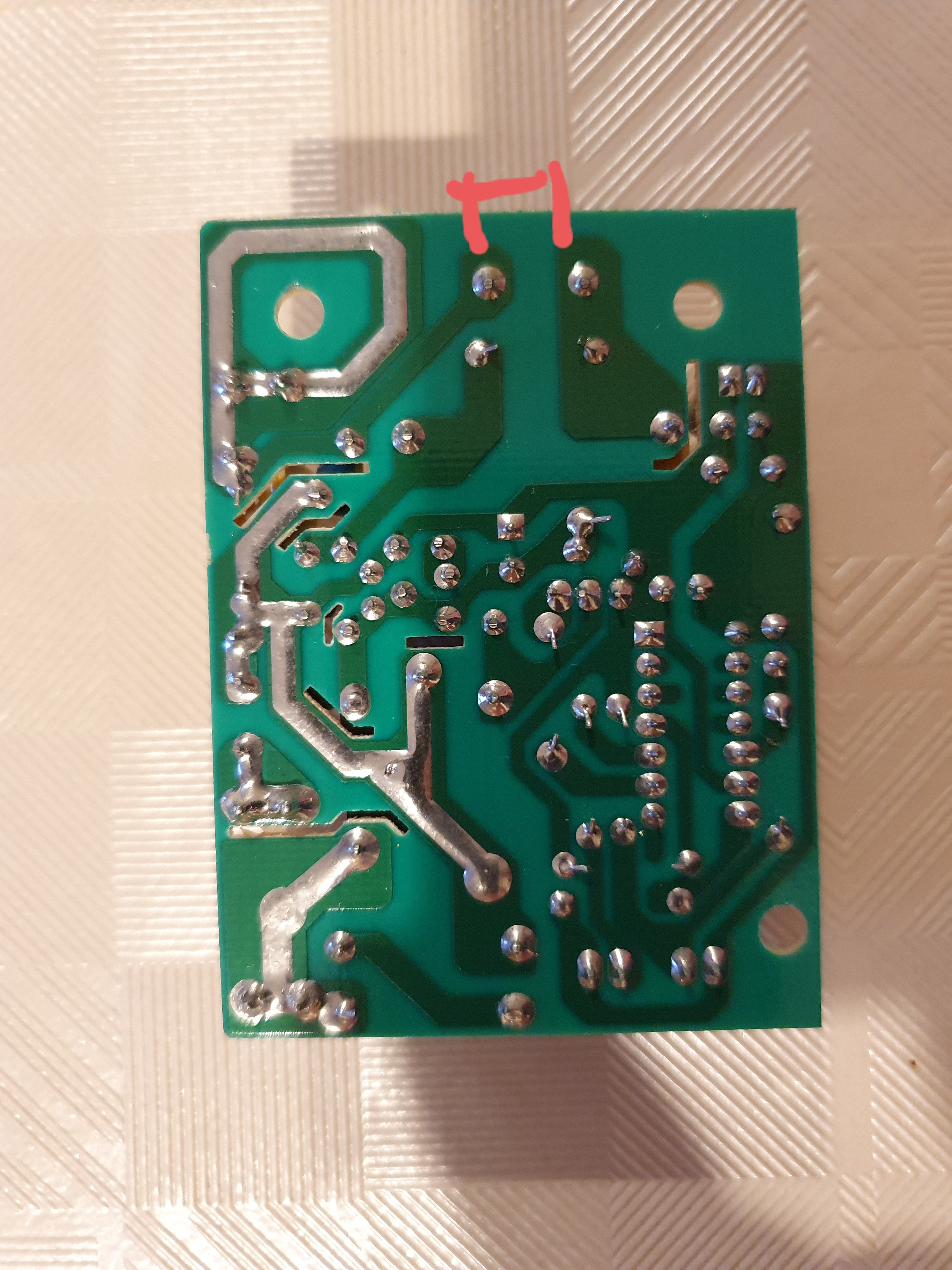

Can you explain your reasoning for suspecting a problem with the 0.1 uF capacitor ? Can you also post the part of the schematic around that you must have traced out to conclude that is is faulty ? From what information I have seen I can't see any reason to suspect that capacitor.
I have added a mirrored version of the etch side of the board to make it easier to trace the schematic in future.
Les.
