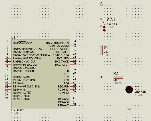

It's well known to not have floating pins as inputs to a microcontroller, and pull-up or pull-down resistors should be used.
My question is whether a diode attached to ground would accomplish the same thing. I know that a diode with current flowing through it has a ~2V drop across it.
Will it be a robust pull-down in the attached circuit when the switch is open?

No. I'd suggest moving R2 to the top of R1 and then use another resistor to pull the pin low. The other problem you have with your circuit is that the switch won't pull the input pin all the way high. It'll pull it up to roughly 4v which will likely be enough for the PIC to register it as being high, but I don't like it.
Can you use a pin on Port B and use the Port B internal pull ups instead? And re-work the circuit around that?

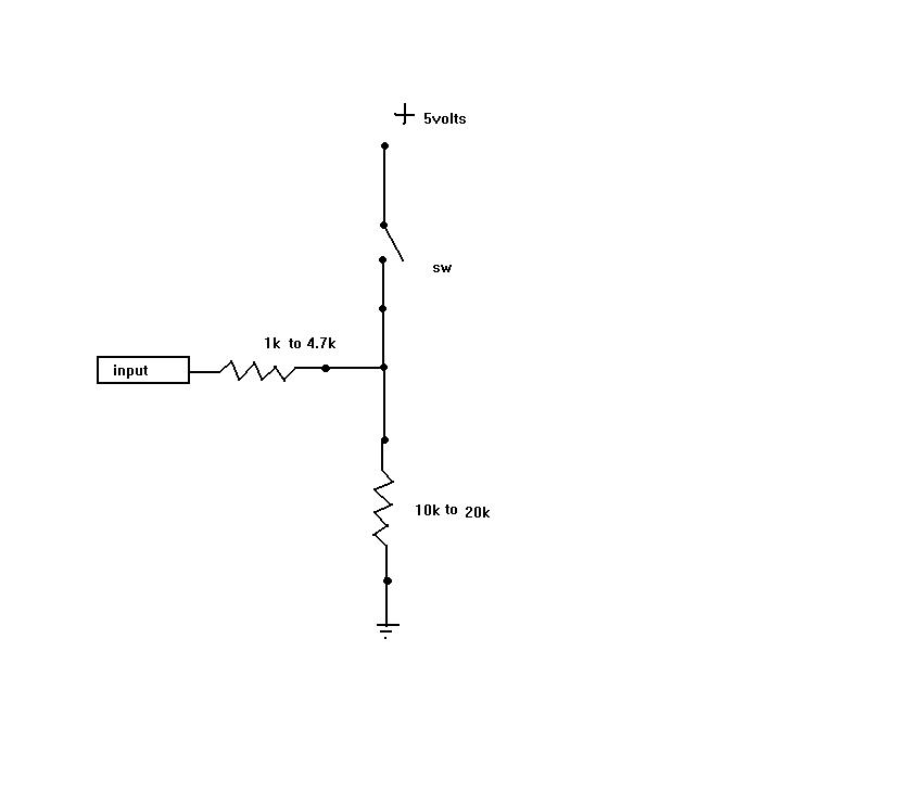

Are you just wanting to use the led to show if you have pressed the switch
I do my switches like this saves power

That circuit will be very poor.
LEDs do not conduct electricity once the voltage gets below 1.2 volts or so. That is just about the threshold voltage for PIC inputs, so it will act as a floating input. Also, LEDS generate voltage when exposed to light, so the circuit's function will depend on ambient light conditions, which will make things even worse.
Put a real pull-down resistor in there.

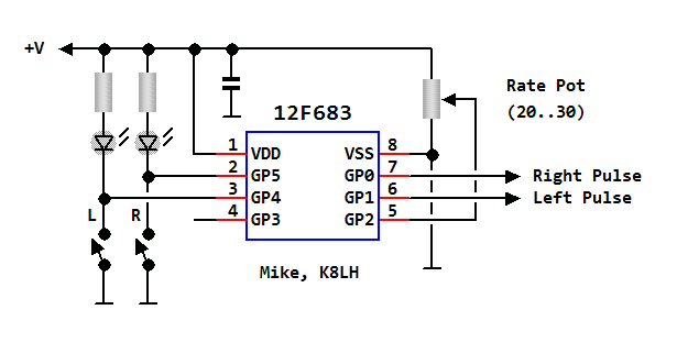

An LED and its current limiting resistor should work fine as a pull-up or pull-down.
In the circuit below I sample the switches periodically by switching the pins to inputs then I switch them back to outputs to illuminate the LEDs. A switch press does illuminate the LED but in the circuit below each switch press toggles the LED so you can't really tell that the switch is lighting the LED.
Regards, Mike

Why you don' put a 50k or higher between GND and RD2 to be shore ? The LED will not act as a reliable pull down.
