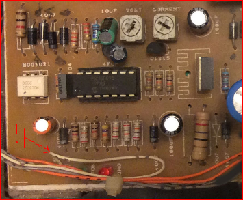

The voltage across the +/- terminals of the PIC above is 5V and that across the opto-coupler is 1.04V.

Given your stated problem (no mains sensing), this area:
is my guess as the area involved in that process (mostly because of the opto-coupler). Could be totally wrong, of course.
I'm assuming that the Orange and Gray wires go to the Batteries. Are they being charged? Where does the White wire (at the !) go (come from)? Trying to track down what is powering (or not) the opto-coupler.
Please include exactly to what pin# of an IC or uC that a trace (or wire) is attached. By way of standard IC pin 1 referencing protocols, you might find this useful:https://www.evilmadscientist.com/2010/basics-finding-pin-1/ This will also help in identifying the rest of the pin#s on the device(s).
The white wire goes to chip LM339N on the Main Board of the UPS given at https://www.electro-tech-online.com/attachments/upload_2015-4-6_0-25-40-jpeg.91812/. ...
To what pin# of the LM339 and to what component does the other end of the White wire go on the "Digital Charger" PCB?

... The opto-coupler shares its ground with that of the bridge above it and its Input voltage comes from a pin on the microcontroller
OK on the ground. What pin# number of the uC goes to what pin# of the opto-coupler?

Pin 9 (+ input to one of the comparators) of the LM339 on the Main PCB.
The voltage at the terminals labeled "Battery connections" above reads: 12.18V
The voltage between GND pin and Pin 9 of the LM339 labeled above reads 4.5V

What is the voltage on pin#14 (the output of comparator #3 that has the 4.5VDC signal from the uC on pin#9, above) and where does the signal from pin#14 go? If possible, follow and note the circuit elements until an IC pin is encountered. Please include the chip ID and the pin#.
With the batteries disconnected from the UPS, does the 12.18VDC (checked as above) change, what is that value, and does the voltage on pin#14 change?
Pin#14 reads 4.5V with respect to the GND pin of the same IC. It connects with pin#7 of the IC above namely st hcf4093be. This seems like a Quad 2-input NAND Schmit trigger.

To me it seems that the two black relays on the main circuit board (where the LM339N is located) are not getting their activation voltage. Once they do, the system might start working again. But, it is hard to trace the exact component activating them as:
-It is difficult to analyze the circuit board in its current position. Moving it to a more convenient position would take the solder off the wires
-The relays seems to be connected to each other and then to a some resistor/capacitor bank. The latter hides the actual component driving them.
See if you can trace back from the 2 connections on each relay that are the relays' coil points to:
