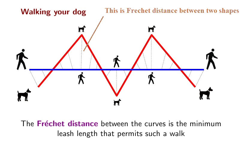

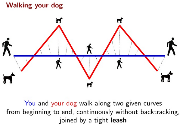

The red sentence is not right. Let's see the picture illustrating Frechet distance below.
As marked in the picture the Frechet distance is the minimum leash that allows the owner and the dog to go to the end of each shape with velocity of dog and owner can be any from zero to a very large.
Your algorithm doesn't make sense. Let's take an example of two shapes that are identical and same position. The Frechet distance should be zero but your algorithm results in a big number.

Yes, I see. However, there is a problem relating to your understanding of Frechet distance and your algorithm. I will show it below.
