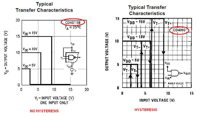

Attached are Vout/Vin transfer curves for a gate without hysteresis (CD4011, 2-input NAND), and a gate with hysteresis (CD4093, 2-input NAND). You can check all the gates in the CD4000 family, and the only other one with hysteresis is CD40106, which is a hex inverter.

Interesting. I don't use a lot of CD4000 series, but I do know all the AC ACT HC etc that I regularly use have quite reliable switching points and hysteresis.
I also have doubts about your first transfer chart for the 4011B, where is it from? I've NEVER seen CMOS gate inputs that had zero hysteresis as shown. Hook one up with a pot on the input and you should see a very obvious hysteresis right around the expected voltages.

I found the same graphs in the Fairchild data sheet of the CD4001BC/CD4011BC.
