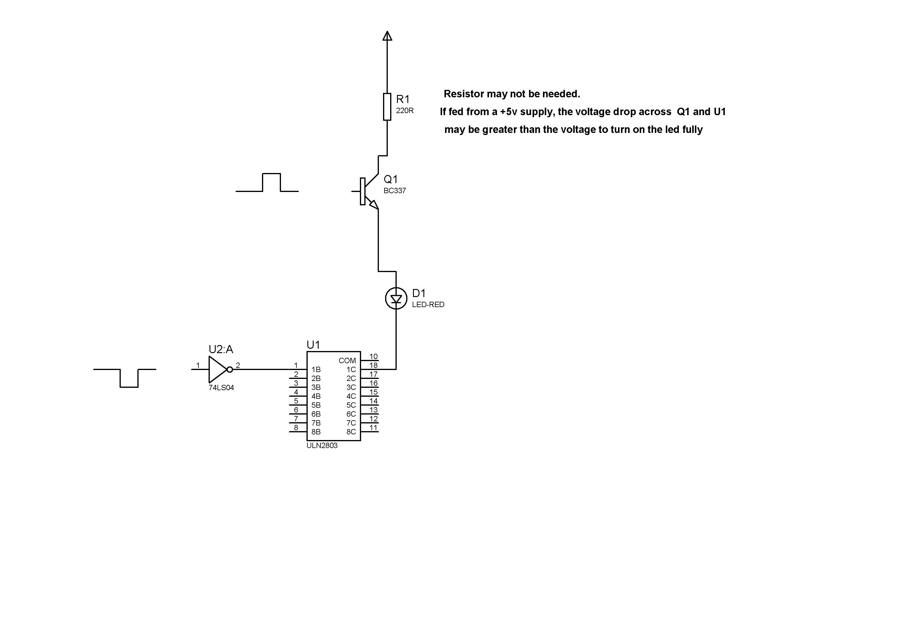

The first experiment was using a NPN transistor for sinking the cathode when the display select was high. Bad result as I saw on a scope that it was the other way around :(
In the next attempt I used one more NPN transistor to make an inverter for the display select signal. It works okay, at least it seems to, but the display output is somewhat low, so I decided to buffer the segment output too, but that gives me a headache as the base voltage is too low when I have to pass it through a series resistor, LED and cathode sink transistor. It just won't light up properly. And on top of that, it requires too many transistors to be nice, 12+12+8 = 32 transistors :s (BTW: I'm using BC547C as they're cheap and reliable with a fairly high hFE).

Two things that may help -
The ULN2003 and ULN2803 range of drivers chips and the 7447 driver / decoder chip - both cheap and available.
Don't know the source of your display info and if those two chips are part of the existing circuit, but what is the possiblity of the source signal being input to a little pic chip so you can display onto a cheap 2 x16 lcd ?

I'd like to help but I started with the likes of AVR's so I tend to avoid 7 segment display entirely, 2x16 or larger line displays are so cheap and easy to interface with I wouldn't even know where to start with the multiplexing alone. I also don't like multiplexing at all because I'm flicker sensitive. Regardless of frequency if you put two identical displays next to me, one fed with the exact same brightness only steady as the multiplexed one I'd be able to tell you which one was multiplex by moving my head no more than a few inches =) It doesn't give me headaches or anything but I notice it and it bugs me.
A simple circuit like this should work but for 12 segements thas a lot of chips.
