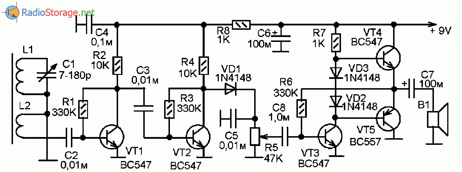

why the Ic at rest of this circuit is so huge (320 ma)?
Yep, a shortcut there was. Breadboards, we love them. Idle is 6 mA now.
yeah, breadboards can do that if you're not careful...
Next: I am planning to use this amp for AM radio, vintage style - transistors only.
Do I need a preamp or I can connect it directly to detector output? I am planning 2 transistors RF amplifier.
This is not a simulation question. This is not a theoretical question.
use at least a two stage audio preamp, assuming your detector is a simple germanium diode (1N34). most transistor radios back in the day had in addition to at least 1 RF amp, a couple of IF amp stages after a mixer stage, but using a superhet design is probably to complex for what you are trying to accomplish. the IF strip part of a superhet radio gives plenty of gain before the detector, requiring less audio gain in later stages. the problem with a superhet is you need a local oscillator (requiring an additional section on a tuning capacitor) and a mixer stage, and then 1 or 2 IF (intermediate frequency, usually 455khz) amplifiers, then the detector followed by a preamp stage, followed by the amp. from what you have written it sounds like you want 2 RF stages, then the detector, then 2 or 3 preamp stages, then the amplifier. just how many preamp stages you will need will depend on how much gain you have in the RF stages.

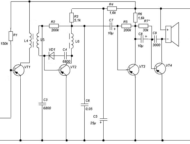

BTW, the second circuit is totally OK, I insist. Finished assembling a receiver with even simpler version of this circuit,works as a charm:
Was a good exercise, now to final step - follow original vintage construction, with vintage Ge transistors. BTW _that_ construction I am planning to make was proven to be functional, reproduced in thousands in1960th...although even today there are hot arguments on how and why actually it works :)
Here is the fragment:

Stan, you show the schematic of a modern "crystal radio" that has two RF amplifiers. A crystal radio was used 60 years ago when there was only one AM radio station in town, so the single tuned LC circuit did not need any selectivity. Today's AM radios have about 5 LC tuned circuits so that you do not hear a bunch of AM stations at the same time. My city and surrounding cities have at least 20 AM radio stations.
The germanium circuit has DC in the speaker which offsets it causing no sound or distortion. The DC also eats batteries.

I forgot to mention that radios have had Automatic-Gain-Control for years but the simple crystal radio with two RF amps posted recently does not, so it will be overloaded and sound extremely distorted if it is near an AM radio station.
