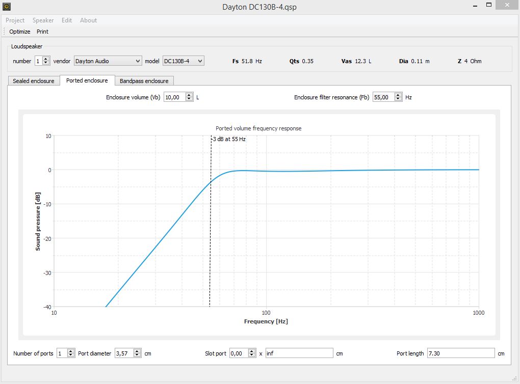

Ok a quick question here. Port. I do it all right. Calculate port volume, then add this volume to enclosure size in the end. But 1 thing i never did is account for port thickness. Right now its 1mm. Do you guys add this also to the calculation ? Its prolly not enough volume to add much to the enclosure size but im just wondering how "far" you go in trying to make it as precise as possible. Reason im asking is, i found a great plastic pipe in my basement and its just about the right size for the port (about 3cm diameter), but its about 2 or 3mm thick. So next time i guess i will add that volume to the equation. Meaning instead of 3cm diameter i will say ok, inner diameter is 3cm so thats what the port is. BUT, when i calculate how much enclosure i must add because of the port, i will actualy use 3.1cm or 3.2cm.
The Dayton tweeter has a nice flat frequency response but its max allowed power is only 10W. I hope it will survive if somebody turns up the volume so the amplifier produces severe high frequency distortion.
The thickness of the port must be enough for it not to flex. The entire volume of the port is much more than its thickness. Then the volume of the thickness is negligible.

In the attached image u can see the line is almost completely flat. It has a whooping 92.1dB at 4 ohms. For comparison dayton tcp115 4 ohm has 86.8dB at 4 ohms. That is 5.3dB difference which translates to about 45% more loudness. I am pretty sure u can notice that. And remember, the person right now is using tcp115 8 ohm version, which has 81.9dB. So if u combine all that, he will hear almost 10dB difference in loudness. If data is correct ofcourse. What do u think ?
The woofer has pretty good bass but it has cone breakup above 2.5kHz causing it to have some shrieking in the sound.

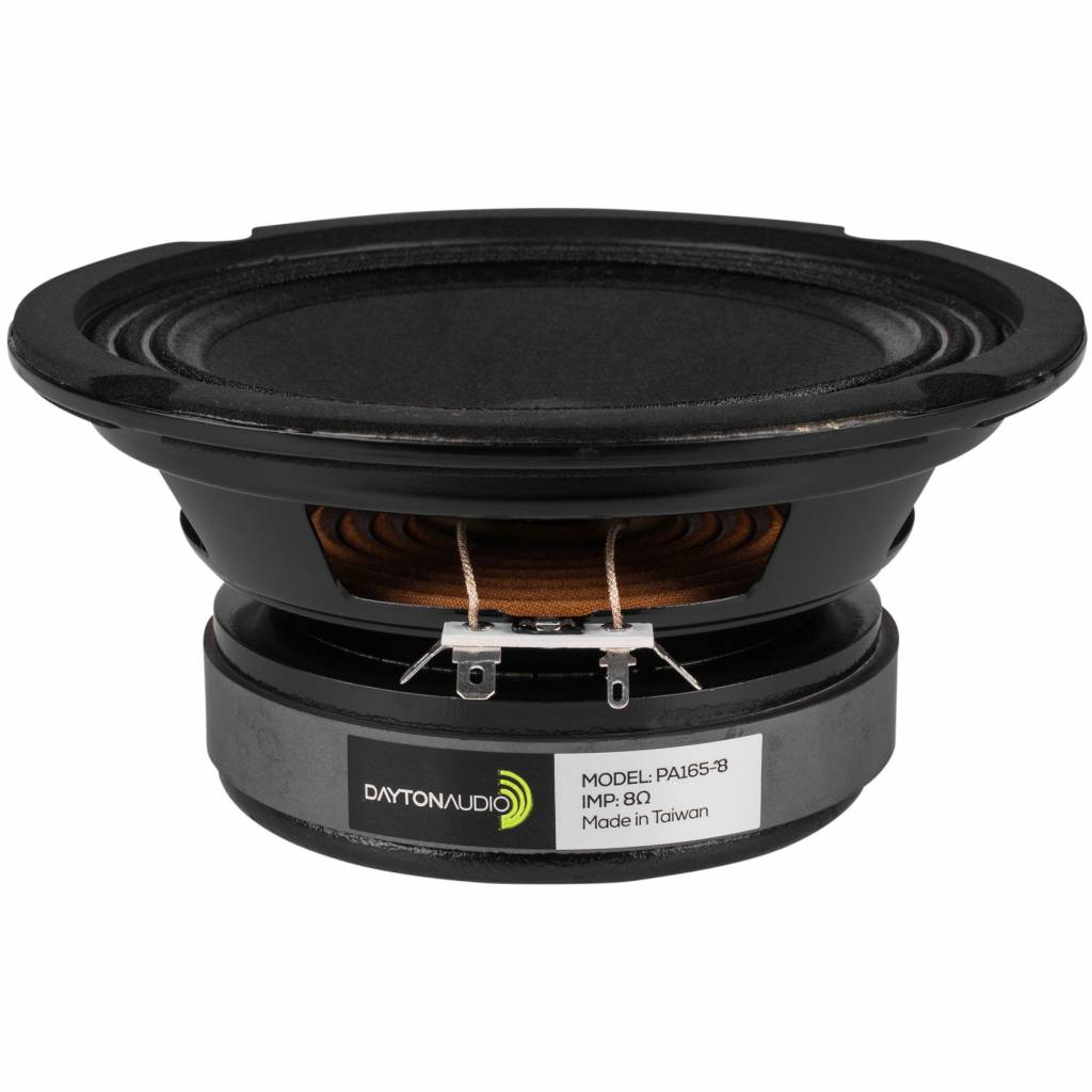

I am making a louder speaker for that person, he said size isnt an issue. My woofer budget is 30 euro/dollar, tweeter about 15. So people suggested me this speaker:
I calculated it and will go to about 65Hz in 15L enclosure and has magnificent sensitivity. Any other alternatives ?
