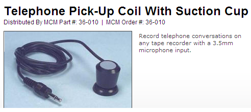

The input is not a transformer. It is a telephone pickup coil.
The output is the "E" laminations and coil from a transformer with the "I" laminations removed so it projects a magnetic field to the strings.

ok, i took a part a cordless phone i got at a thrift store and the pickup (i'm assuming that is the part you talk into) is two little black 1'' diameter mics is that what you are supposed to use? the speaker looks more like what i was imagining it is aboutt 2'' diameter would it work?

The telephone pickup coil is a recording accessory and is not part of a telephone. It picks up the magnetic field of the earphone of a telephone.

OK, i built the whole thing exactly how it said to and it 1/2 way works. it will sustain (but not infinite) it if i pluck the string then put the pickup up to the string and the transformer kind of under the string really close to the coil any ideas? also i thought ebows are supposed to change the sound this just sustains the normal noise.

Have you tried adding magnetism to the sensor?
the sensor is the pickup coil. If it hasn't already, add a magnet to it. Attach with a bit of blu-tac that's all! I think it will increase sensitivty of pickup

I tried the adding a magnetic to the sensor and it made it a little bit more sensitive but i think the problem is that whenever i touch the sensor on the string that it muted the string any ideas what i should do?
and are you supposed to touch the output transformer/coil on the string?
