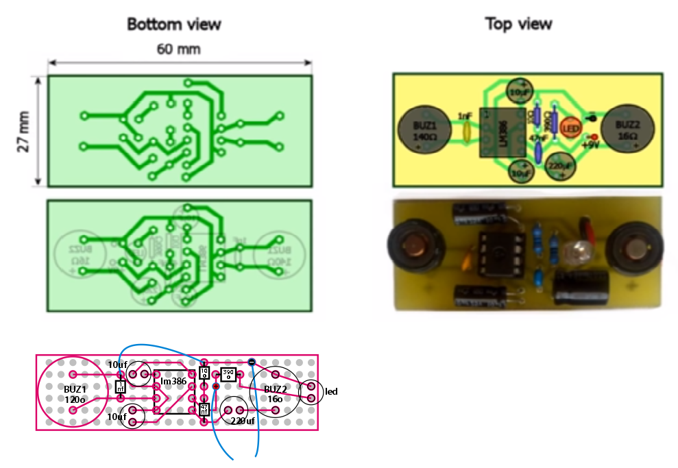

a plea: should you be kind and take a look ad my little diagram and tell me if it's ok?
the upper images are from an youtube video, the lower diagram is mine and is narrower (15mm instead of 27mm), like the 9v battery side narrow face (i'm thinking at a flat, altoid-style box for the thing instead of the boxy ebow standard design)
i will use a predrilled board (don't know the english name, in italian is "millefori", thousand-holes
thanks!
