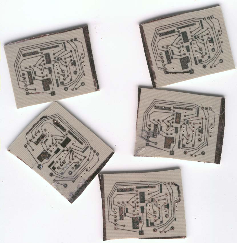

for etching - 1 part muratic acid and 2 parts hydrogen peroxide. cheaper, easier and seems to work just as fast.as the brown etching gunk.In the scan I havn't cleaned or cut square the boards yet.

In time your boards will look as good as commerical ones. I have been cooling my boards prior to soaking the paper off. Need to try em hot.

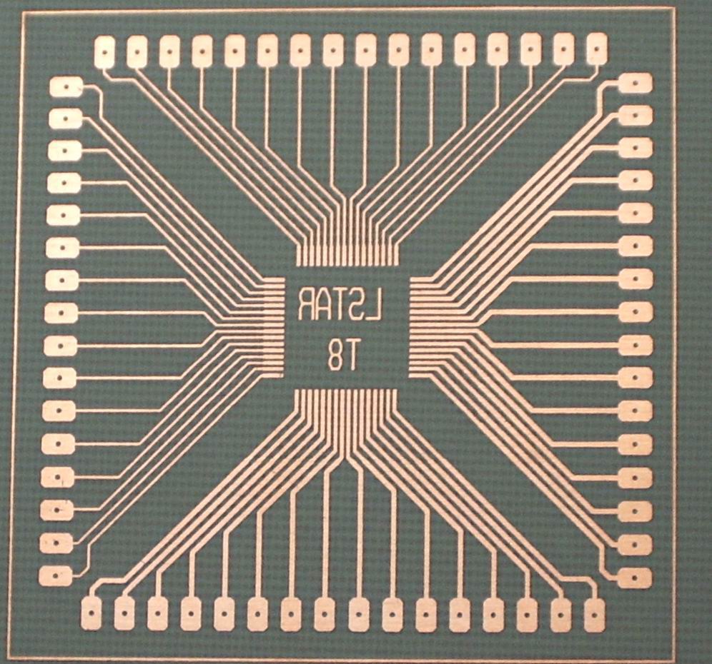

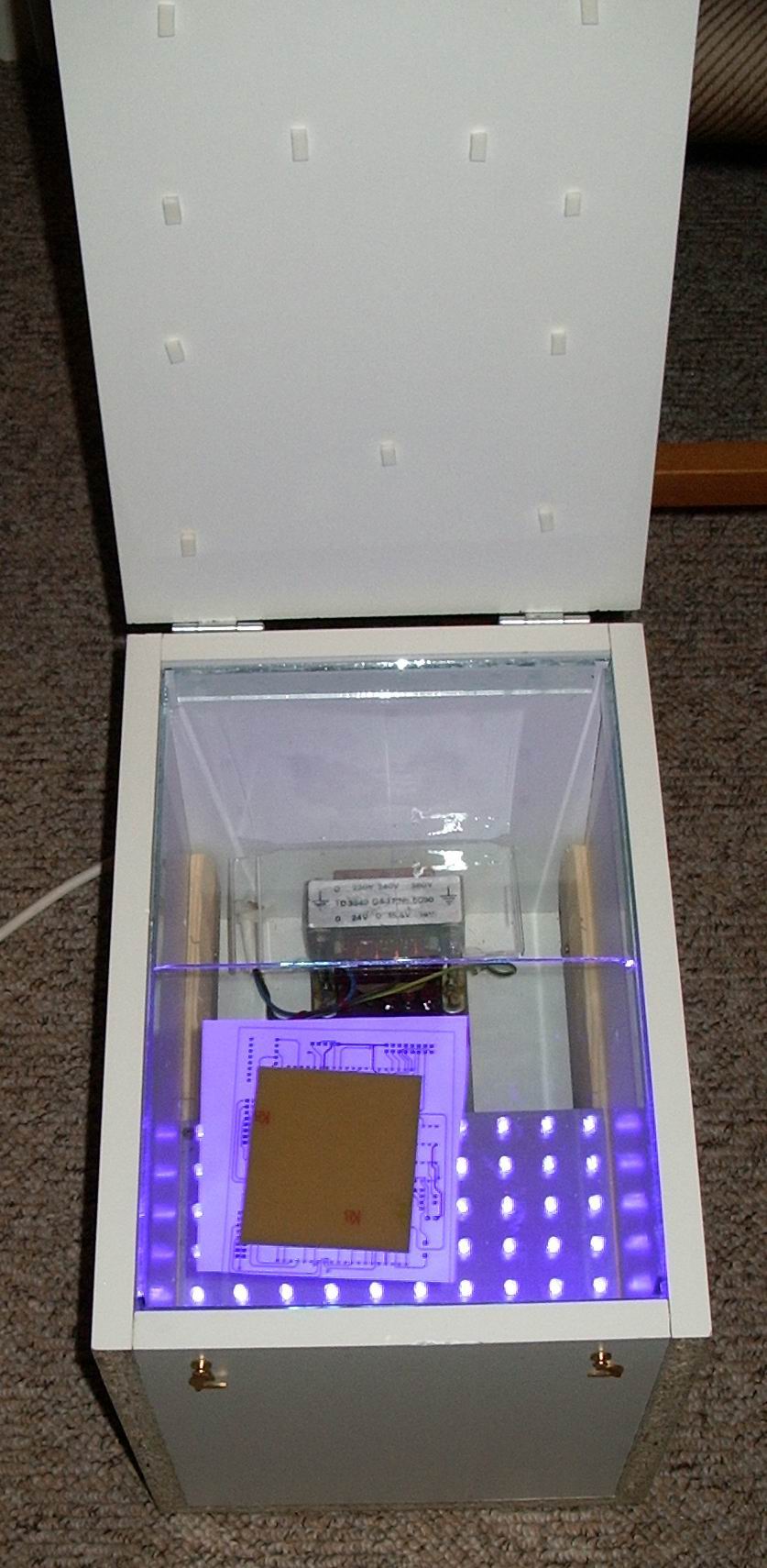

Interesting results - I thought long and hard about trying the Pulsar system, but the shipping / delivery times were difficult - so decided to try a diy LED UV box.
Although the presensitised boards are expensive - haven't looked back - the results are good and consistent as the pics show - the pcb has T8 and T12 tracks.

Very nice results Richard.
What UV LEDs are those ? I've got a nice double sided scanner I'm planning on using for exposing my PCBs when I get round to adapting it with LEDs :)
Fairly standard 5mm ones - have used them from both these suppliers who gave good service.

picbits Out of curiousity, what is your exposure time on the LED box Richard ?
4.5 mins for pre coated boards from Farnells or Mega - although that will very much depend on your leds parameters, their spacing and distance from the copy.
The only helpful facts I found was from this Elektor article - but use it as a general guide only, those paricular leds are not readily available any more .
https://www.electro-tech-online.com/custompdfs/2009/05/uv_light_box.pdf

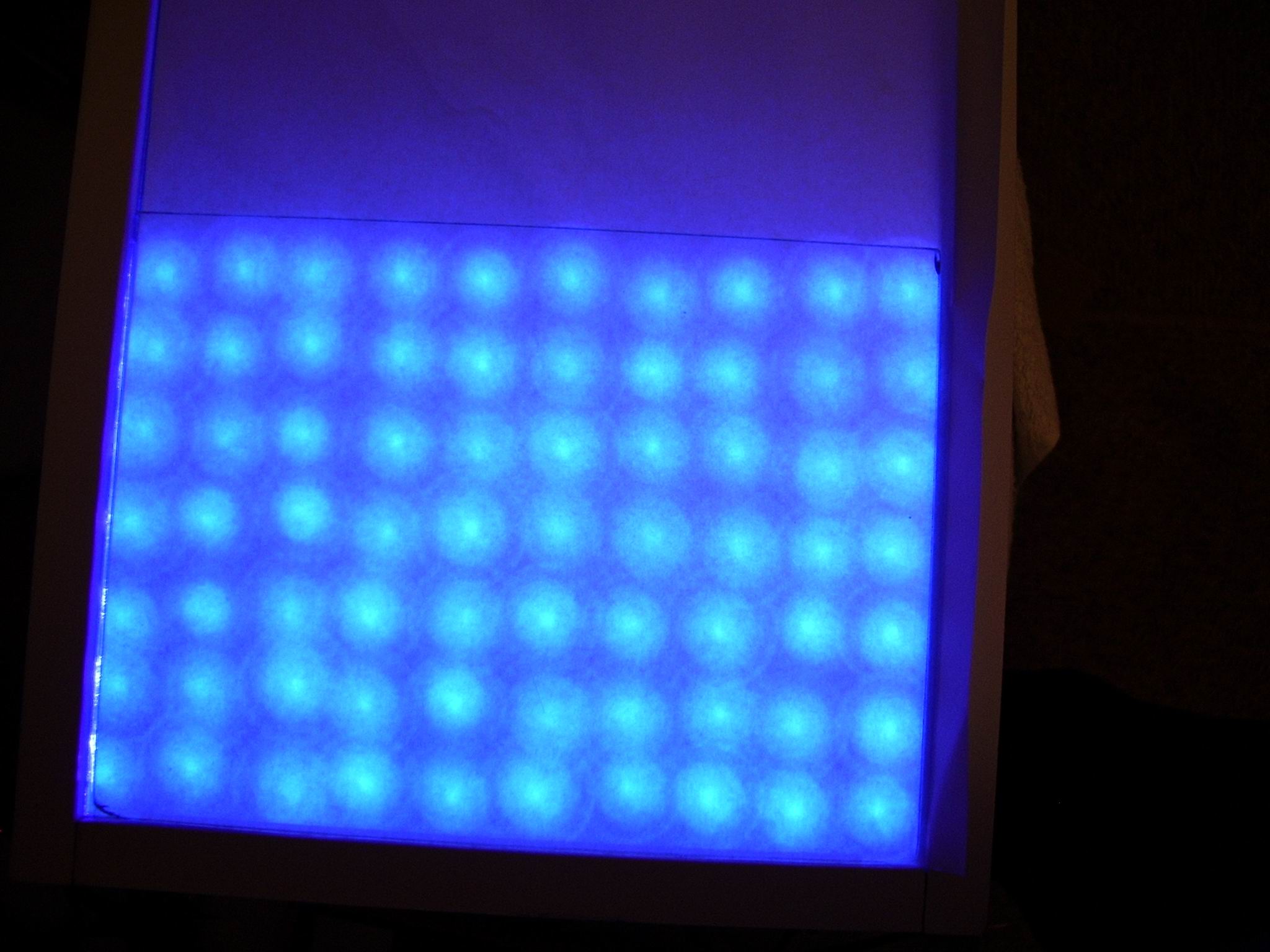

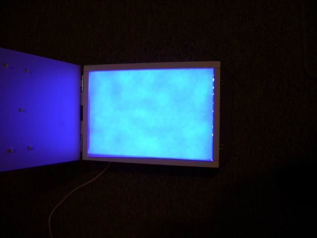

Both me and a friend found that the leds, 5mm at 20deg ,130mcd, 20mm spacing needed to be positioned much further away from the copy to give an even light spread - typically 6" or more.
If you cover your copy board with plain paper, it shows how good the led beams are - the first pic is at the Elektor suggested distance the latter at 6 inch depth which does give, in practice, a good even coverage across the entire A5 area and produced the t8 tracks shown earlier.

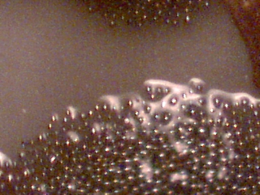

There are several ways to build a SMD board.
You can solder the parts in place using a soldering iron.
The remaining methods use solder paste.
paste_200x-jpg.24999
Solder Paste 200X
It is a flux paste with tiny balls of solder in it. The paste is applied to the PCB solder pads using a syringe or a stencil and squeege. You can have clear plastic stencils cut by Pololu or etch them from brass sheets. I cut my plastic stencils using a method I worked out for the cricut.
Once the paste is on heat the PCB to melt or reflow the solder.
The use of electric fry pans was first suggested by SparkFun Electronics. They used this method for production until recently. Sparkfun has several good tutorials on SMD soldering. Sparkfun tutorials
More "professional" soldering is done in an oven. A contoller is used to ramp the temperature up and down according to a specified profile. Some people have modified toaster ovens to follow the profile.
