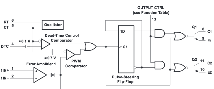

Did u ever observe that if the pulse width of the TL494 gets under say 8uSec (with pin 13 tied hi) with a low frequency (1K clock) it will divide the clock in half and widen the pulse width?

Quick question Ron...
Usually, with the tl494, to achieve a 96% Duty range I would have pin 13 tied to 5V and parallel the two outputs.
Can't the same be done with pin 13 tied to ground and a single output used?
I think you are right. If the Cs and Es are tied together pin 13 has no function.
