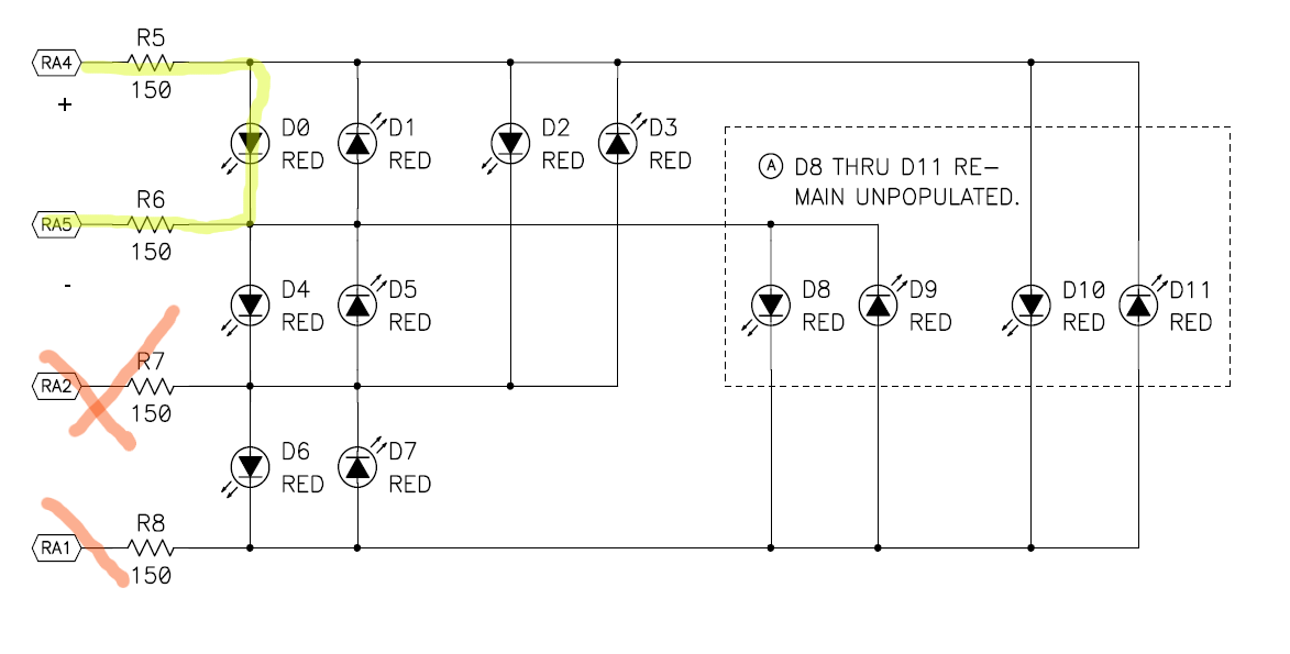

I'm a total novice when it comes to embedded programming, I've been playing around with C for years, but never consistently, it seems I have to re-learn it all each time I come around to using it....
I've been given a microchip pickit1 flash starter kit with a pic12f675 onboard and I'm banging my head on a wall trying to make a single LED flash.... I can make two flash at once, but isolating a single one seems beyond me at the moment!
my problem is that the LEDs on the demo board are wired in a tri-state configuration and I don't seem to be able to set the pins in a high Z configuration. I'm using pin 3 to source the current for the LED, pin 2 to sink it, and setting pins 5 and 6 to input mode (High Z I believe)

Looks like the schematic at
https://www.electro-tech-online.com/custompdfs/2009/01/PICKkitUserGuide.pdf
Your code should light LED DO only. Which are lighting ? You can tell the state and value for each of you IO bits by looking at the schematic and knowing which LEDs are conducting/on. If D0 and D2 are on RA2 is a low output rather then an input. If DO and D10 are on RA1 is a low output rather then an input etc.
You can also use a logic probe or volt meter to check that you can configure GPIO bits as you expect them.
After a quick look I did not see a problem with thecode.
It should NOT make a difference but try 0b00000011 as the value for TRISIO.
Is the board new or is it possible it has been modified.
At the very least tell us what LEDs are on. It will help soft out any software to hardware mapping problem.

the two that are on are D0 (the one I'm trying to light) and D2, I'll try the change to the TRISIO value out and let you know if it works after the weekend :)
The board isn't new, but as far as I can tell it's not been modified

If D0 and D2 are on RA2 is a low output rather then an input. That is to say RA2 is providing a path to ground for LED D2.
The datasheet says weak pullups are active on power up and other resets. --11 -111 RA2 would need to be a low ouput to light D2, this should not be a problem. You could set WPU = 0x00 to be paranoid safe.
There are times when things that should not be problems are. Either due to misunderstanding or some quirk. For that reason the paranoid but safe way is best.
As I see it you need to figure out how RA2 is providing a path to ground D2
HTH
Bits are numbered 0 1 2 3 4 5 6 7
You need to trisate bits 1 and 2 which can be done with
TRISIO=0x000110
but instead you are doing
TRISIO=0x000011
which tristates bits RA0 and RA1 instead of RA1 and RA2.
It fits. We have all made this mistake :)

It's sinking down to RA2 I tried it. My ideal didn't work I figured make all pins output would stop it but it still sink to RA2 to turn on D2. If you source RA4 and sink RA5 D2 come's on to. If you make RA2 high to turn off D2 you lite 3 leds
I can flash the leds in a roll but it don't want to turn on just 1 lol I see why it would drive you cazy
It is not difficult. You can figure out which lines are hi low or tristated for each LED by looking at the schematic.

thanks for the help guys, I think we've cracked it, it annoys me that I left everything at work so can't test it before tuesday!

this flashes just D0
thanks for the help guys, I'm in the middle of moving house at the moment and had to take an extra day off work yesterday to pack stuff, so I didnt get a chance to try the new code until today.
Suffice to say it worked, it was a simple case of setting the TRISIO register value to 0b000110 instead of 0b000011
