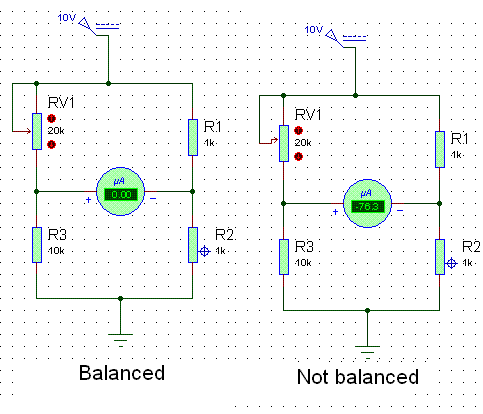

The bridge works on the principle of ratios. From the diagram:
When balanced RV1/R3 = R1/R2
So if you have 1 unknown value for say R3, by taking ratios (when the bridge is balanced with no current flow in the uA meter) you can determine the unknown value. RV1 will be a precision adjustable component with calibrated scale or markings according to set value. R1 and R2 will also be very accurate components.

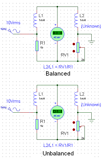

The first diagram shows a bridge for finding unknown inductance. When the bridge is in balance there's no AC voltage on the meter. (work better with a high impedance earphone as Nigel suggested, but my program lack a symbol for it)
The next diagram shows the bridge unbalanced.
The next set of diagrams are interesting. The problem arise that when you have two inductors with the same inductance but one has lower Q (due to extra series resistance of the inductor as indicated by the 10R resistor in the block surrounding the inductor on the right) you are unable to find a null position even though the amplitude over the inductances can be adjusted to be equal by RV3. This happens because of the phase difference that exists. By using a phasing control, we can now insert extra series resistance in one of the two legs to make the bridge null out. At the same time we can determine the Q of the unknown inductance from Q = XL/(set value of RV2)
