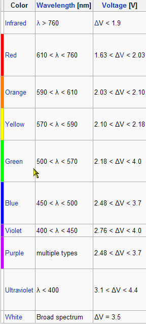

The colour of the LED determines the voltage drop across the LED.
