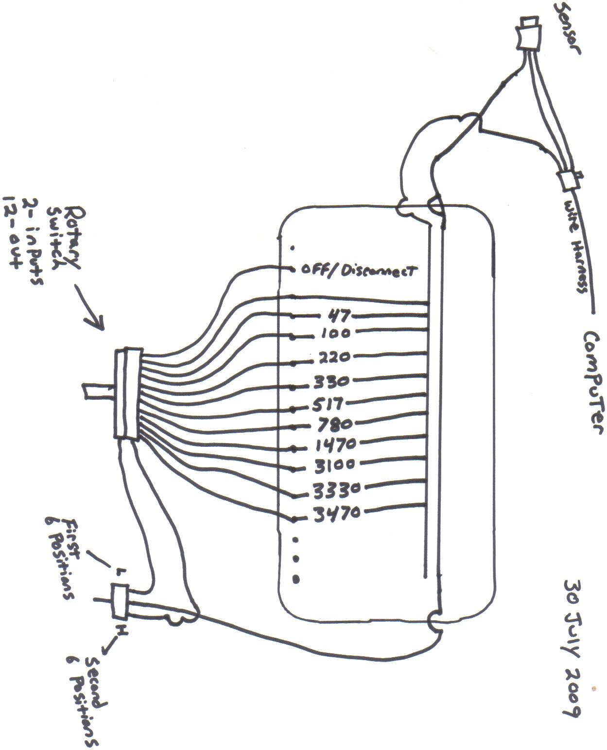

I made a controller (for lack of a better term) to be placed between an engine sensor and the computer to trick it into believing there is a load when there is not but the sensor is still part of the loop and is functional.
For example, if I place a resistor in line, there will be a false reading that the computer will recognize.
The controller has multiple settings with the resistance increasing as the switch is set to the next setting.
The sensor needs to remain in the circuit and be functional or a problem code will flash but my problem is, if the sensor operates properly and my false resistance is added to sensor reading, the level will go to high and it will throw another problem code. (and the computer will intervene)

I did this from my head to the completed project so i dont have a diagram.
Basically, this is placed between the sensor and the computer, through a 6 position rotary switch which then goes to the circuit board and the various resistors.
The sensor should operate through the unit but depending on the setting, the additional resistance is added.
My guess is the computer will throw up the red flags when a resistance of 4-5K is achieved.
My added resistance values start at 47 and go to 3,400.
If the sensors actual functioning value at a full engine load is say........3,600 then the value of the setting is added, the computer will not be happy.
The sensor operates from 0 (or almost zero) going up in value depending on engine load.
Is my explanation helping or just confusing you and making me look worse? :-/

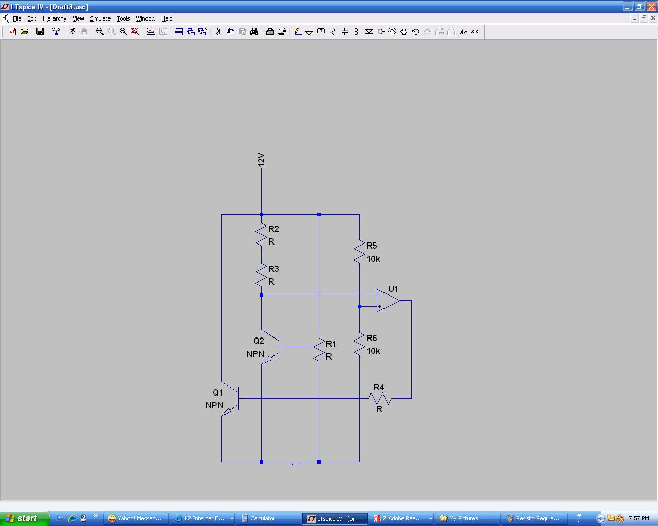

Maybe something like this: Transistor Q2 is set to the current to satisfy the computer. R3 represents the sensor, and R2 is chosen to give slightly more than 6V at the "-" input to the comparator. If the sensor is giving > 0 resistance, then the inverting input goes below 6V, and the output of the comparator turns on Q1, which supplies enough current to keep the computer happy.

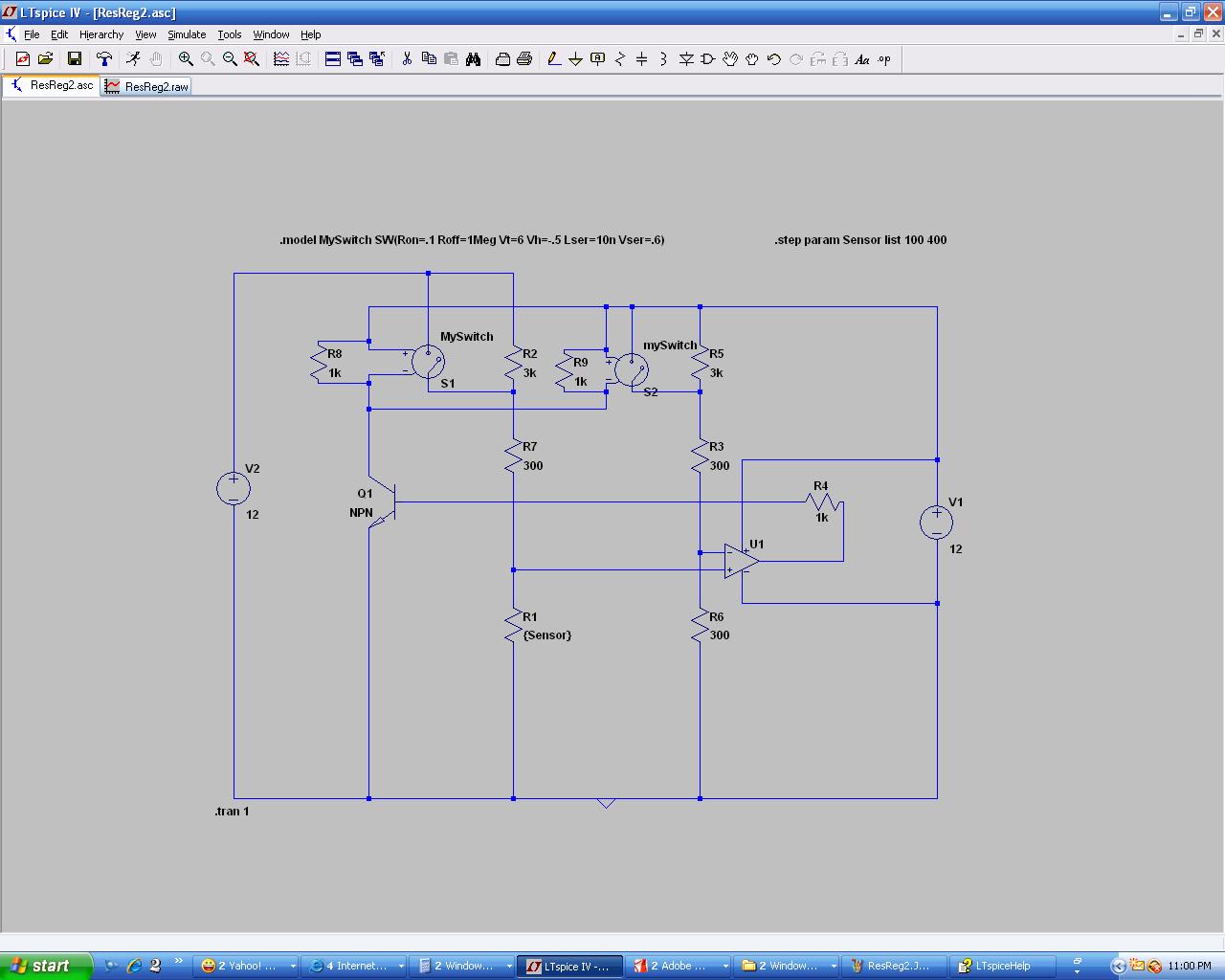

Yes, that's doable. If you want to do it this way, I can cobble up a diagram.

In the attached circuit, the switches and associatd resistors are intended to model realys. If you build this circuit, or a similar one, replace the switches and resistors with relays, and add the protection diode. The sensor is modeled by R1. When the sensor is at zero volts, the relays are de-energized, and the resistance seen by the computer is 3.3kOhm. When the sensor is over 300Ohms, the relays are energized, and the computer is looking at the sensor reisitance plus R1. This version reads an error, becuase it adds the value of R1. We can twittle the values of the reisitors so that error is small, if your system can tolerate that.
Simulation has verified the operation as described.

I made a diagram of my contraption. (kindergarten style compared to yours) but i think it will give you an idea of what I'm working with.
The sensor has 3 wires. when disconnected, the wire harness will have 6.5 volts on the brown wire, 5.05 volts on orange and zero on yellow.
When plugged into the sensor, 6.5 brown, 1.something orange, zero yellow.
When i place a resistor in the yellow line, the computer will register the reading.
The system is 12vdc.

Is the yellow wire the return? What are the functions of the brown and orange wires?
