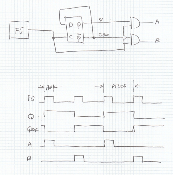

Does this work?

The picture is too small to see.
I don't know why it won't enlage? I'll try this

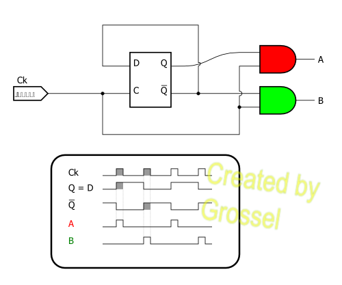

It splits the input pulses so that each second pulse input is transfered to output A and the other half is transfered to B.
Reminds me about a demux, but it's not. I dont know how to possible use such a circuit. Nice if anybody having an idea how to use it :)
It will work as drawn.
I'm going to use it to make an Electrical Discharge Machine. This will allow me to turn on alternating mosfets to charge and discharge two capacitor banks. The capacitors will be connected to a shaped electrode to machine metal.

I think if I where going to make a driver for a push-pull transformer with basic components (no µPC) then using this circuit would make sense. If adjacent pulses is of same duration, then it should resolve problems with unbalanced DC in transformer. Assuming changes over time won't affect this balance particularly.
I assume if the circuit is possible to expand, so that it split the input pulses out to three separate outputs- then it would make it pretty easy to do PMW on a reluctance motor.
I have redrawn the circuit. Looks pretty nice, doesn't it?
