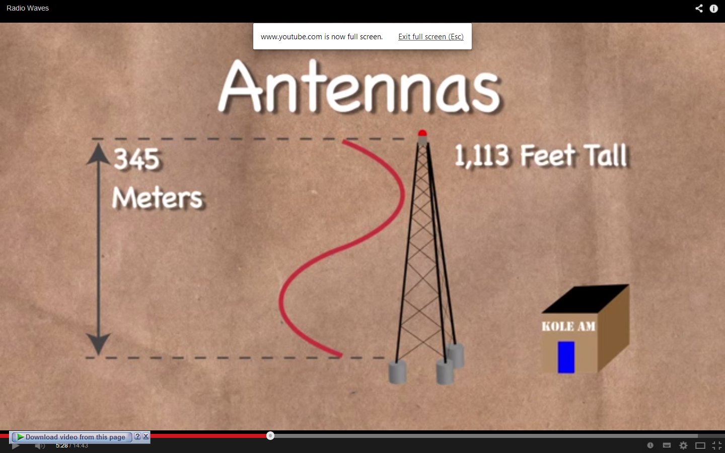

does wavelength determine height of antenna
in the image 354 wavelength correspond to 840 MHz.does wavelength decides height of antenna.if that so for low frequency signal.they have to build ery taller tower.is it possible to build such high antenna
354 meter/1113 feet tower Yes I have worked on towers like that. These are used for AM radio. The tower is a antenna.
1500 feet is the tallest I have seen. The tower was not used as a antenna. It has several FM and TV antennas on it.

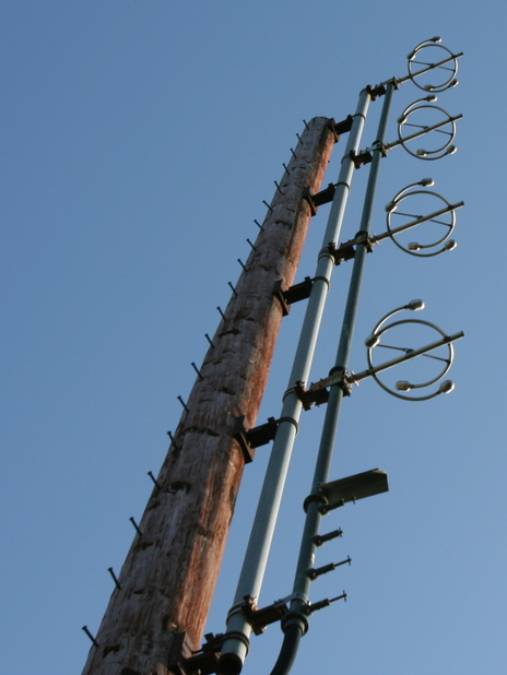

FM directional antenna: That antenna is not directional in the North/South/East/West directions. It is very directional in the up/down direction. There is really no reason to send FM music into space. (or down into ground)

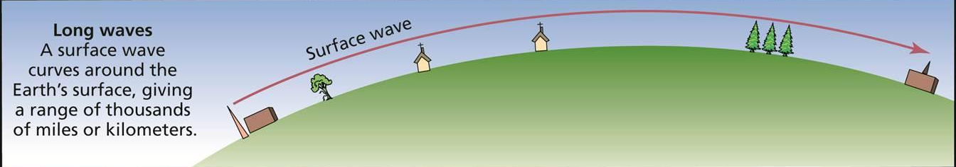

AM radio (low frequency) travel a long distance because low frequency radio waves bends when traveling around a round world.
FM radio (high frequency) travels in a straight line. So it does not bend beyond the horizon.
No that antenna is directional in that it focus the energy.
Lower frequencies have the property of following the curvature of the earth. (surface wave or ground wave)
High frequency is more like light and it will not bend to follow a curved earth.

Hi bhuvaneshnick,
First of all, a minor correction ;). In post #1, either the frequency or the wavelength is wrong. A wavelength of 354 metres corresponds to a frequency of 869 kilohertz not megahertz. Conversely, a frequency of 840 MHz corresponds to a wavelength of 0.354 metres. These are important distinctions because of the frequency dependence of radio wave propagation. And since the above correction is simply a side-issue to the main thrust of your question, ignore it:D, and instead have a look at the following pages:

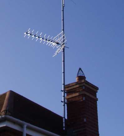

Here is a picture of a short antenna on a pipe on a building. The antenna pieces are about 6 inches long. (left to right)
This antenna is 6 feet long. On a pipe to hold it high in the air.

2. Yes. The lower the frequency, the more it can bend around the earth or reflect off the ionosphere. The higher the frequency, the shorter the antenna, the more direct the transmission. It bends less.
