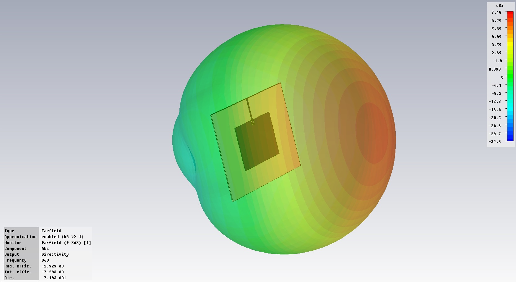

From experience a micro strip patch antenna with center frequency 866 Mhz with 10 mhz bandwidth was about 20 cm by 20cm @~8 dBm directive.:confused:
The antenna has got a "directive" gain of about 8 Decibel meter. The simulation result of that particular antenna is attached.
A quick goog-fu had this , thank god for google, else I would have to get down with the latex editor.
OK, but what is a decibel meter ?
I confused dBi with some other term dbm, what I meant was the forward gain for the antenna. The thing was that , 36dBm was the power we are delivering to the antenna .
LOL no such thing as a decibel metre ( or meter)
as you will be probably aware Jim, but magvitron doesn't appear to be, dBm is dB related to 1mW ( one milliWatt)
his 36 dBm = 4 Watts
