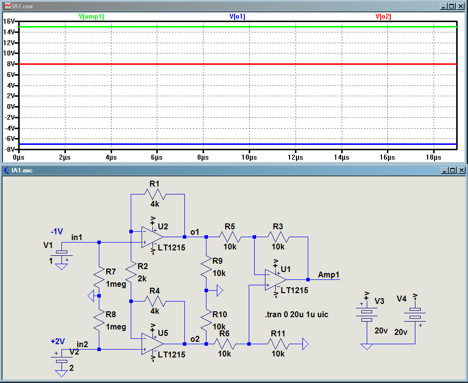

Look at this inst Amp simulation, it shows the result I posted earlier.
The -G is set for *4, but the +G is 5.
So as its got a differential input of 3Volts it gives 15Vout.

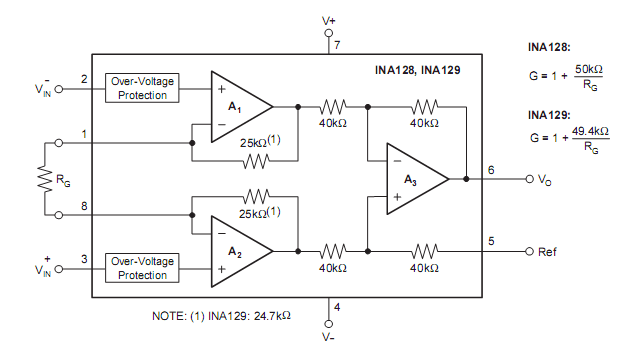

Looking at the image of the 1NA128 you will see even though the NI inputs are used as the input pins, one is marked +Vin and the other -Vin.

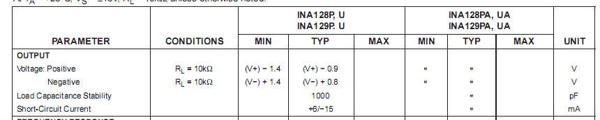

Your 1NA128 overall gain figure is G = 1 + [50k/12.5k] = 5
So if you have a 3V input difference to the IA then the output would be 15V,
BUT if you look at the output limits for a +/-15V supply you can see that you are its not able to output 15v.!
Typical is about 1V less than the supply voltage, so you will see the 14V value which you quoted earlier.:)

Eric, I don't get the "-G is set for *4".:confused:
Here's my analysis:
o1 = 3*v1-2*v2 = -7
o2 = 3*v2-2*v1 = +8
amp1 = o2-o1 = 3*v2-2*v1-3*v1+2*v2 = 5*v2-5*v1 = 5*(v2-v1) = +15

hi Ron,
Its one of the cases where the OP has defined inv and non-inv inputs when referring to an intrumentation amplifier, in which I believe he really meant a common OPA.???
If you look at his other thread regarding inst amps, helpers are experiencing like problems in trying to determine which type of amp he is asking about.
https://www.electro-tech-online.com/threads/instrumentation-op-amp-question.99320/
My analysis for a IA gives the same results as you have posted.
I should have more clearly explained that the -G referred too, is a standard OPA when using the input voltage values he posted in his first post.:eek:
The OP states a psu supply of +/-15V, but the output required by his original input voltages is +15V, which the amp cannot realise, so thats where his +14V reading is confusing him.
I'm sorry there has been so much confusion. I tried not to overcomplicate my question with a lot of minute details. It's been a long time since I've done this work. I've been brought on board to help with EE related items. Some of which are circuit and PCB level items. The catch to the job was that they want to be self-sufficient in updating their circuit/PCB designs but don't have the software to do it. I'm using software I got 10-12 years ago and using the lingo I remember and found in the data sheets. The datasheets refer to the amps as "instrumentation amplifier" and are based on the op amp design detailed in one post. The sheets also refers to a singular gain as specified by Rg and inverting and non-inverting for the descriptors of IN+ and IN-.
As for the numbers in my example, they were just pulled out of a hat and not actual real world setup. I'm trying to refresh and grasp a concept that I used to know without thinking of it. The 14V that is confusing has nothing to do with the +/15VDC supply voltage and the fact the IAs aren't rail to rail. The 14V is confusing because I expected a different number, either 12 or 9. If anything the confusing part is due to the non-rail to rail amp will only reach 14V which is coincidentally also one of the answers (where gain is defined a 1+). Then on top of that I posted a schematic with the wrong resistor value and forget the 1+ that is blatently written in the equation on the first page of each datasheet (G=1+x/Rg).
I thank you all for your help. I got a lab setup started and was able to experiment a little with the IA. Vout = (IN+ - IN-) * G. Straight up. If IN- is negative then it will raise the output by abs(IN-)*G.
