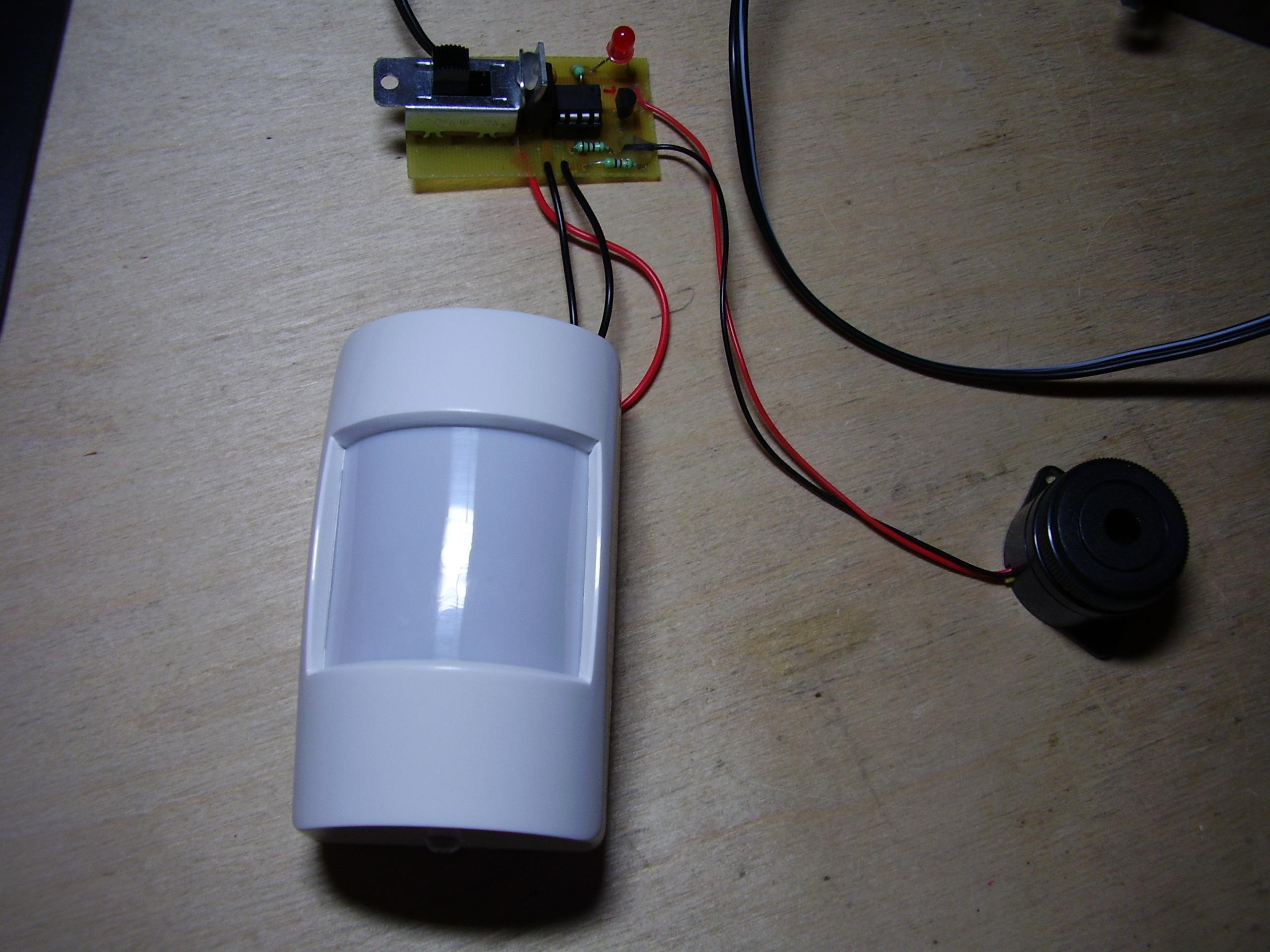

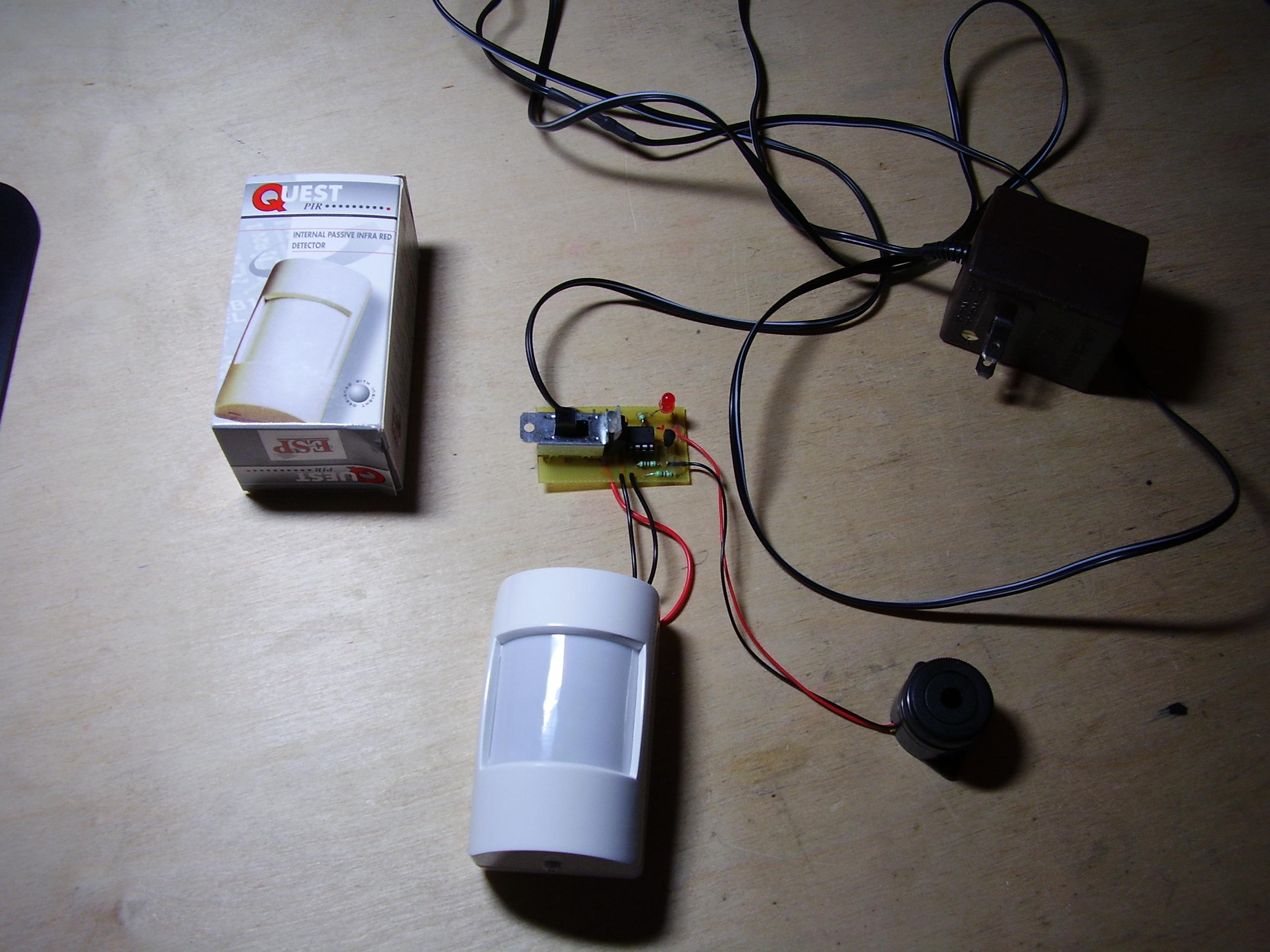

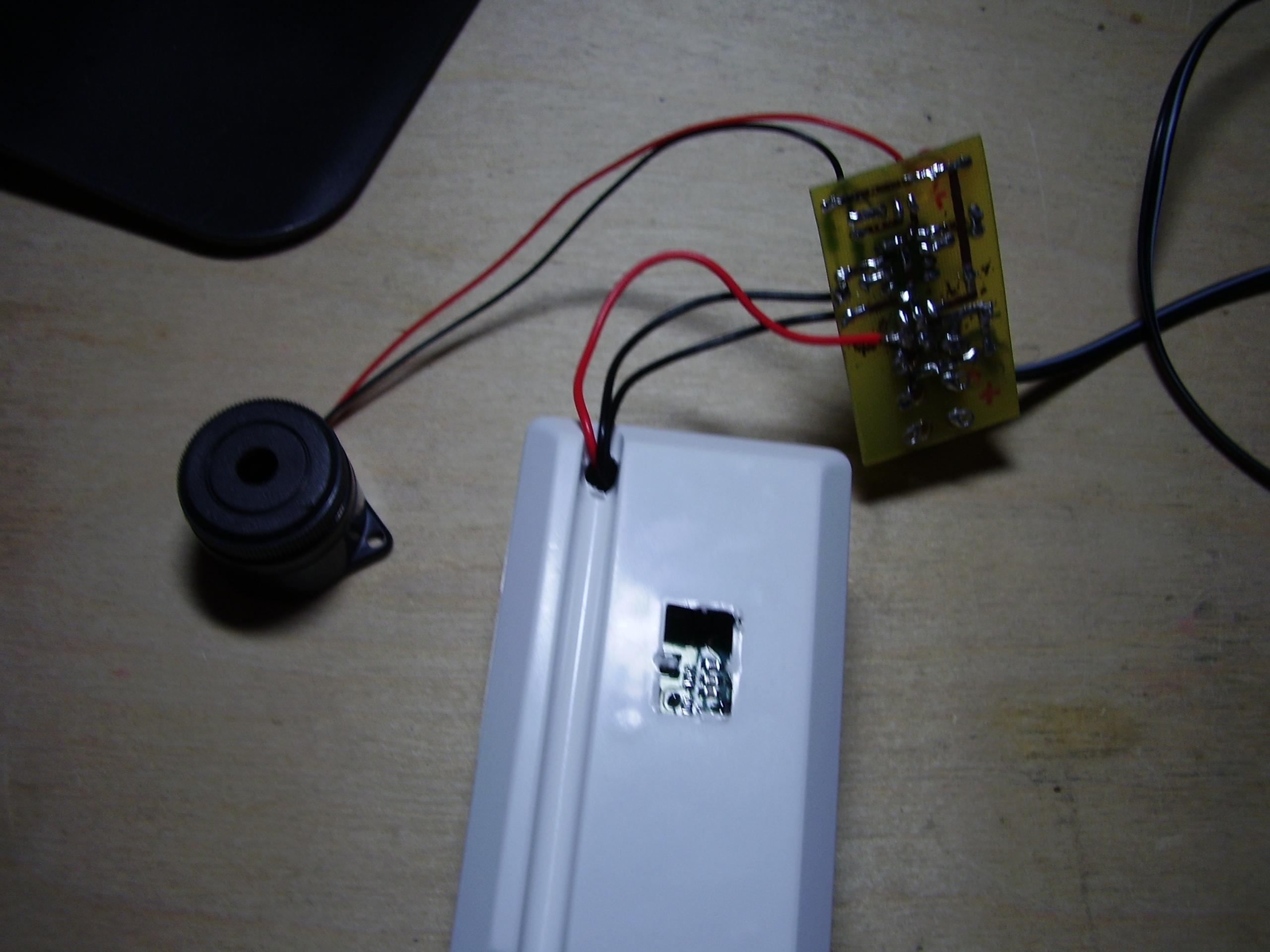

Here is the finished circuit.
Basically when you switch the slide switch on.. the PIR turns on and waits 60 seconds to adjust to the surroundings.
When motion is detected the relay in the PIR opens.. triggering the exterior circuit I made .. a 12f629 pic then beeps the buzzer.
Works flawlessly.
Bought 10 of these PIRs for only $50 CDN on eBay.
