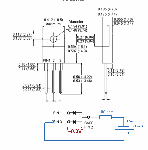

As you say, I would expect a forward drop of around 0.3V or so,when forward biassed and almost infinity when reverse biassed.
I would make a small test jig , see the image, and check the actual voltage drop across the diodes when forward biassed and reverse biassed.
This would check that your DVM on 'Diode' measure is working correctly.
Use your DVM on say DC volts setting around 2.5V or so.
Lets us know what you measure.
E.

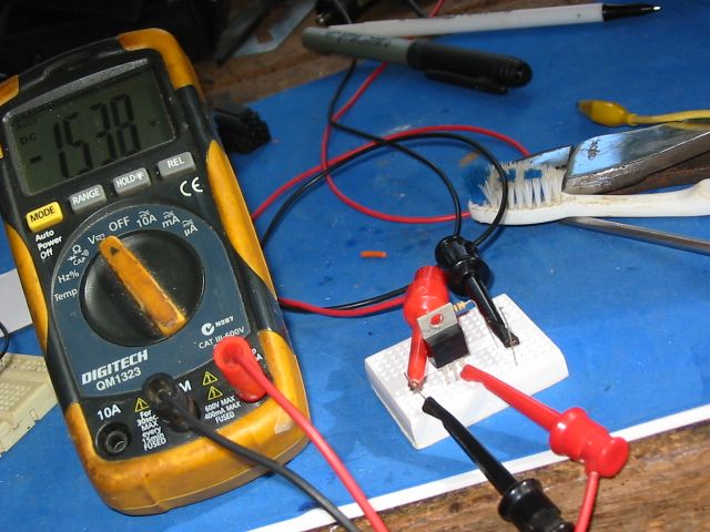

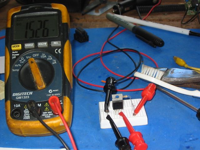

I measure full voltage
When I swap the battery polarity I measure full voltage too?
Top clips are from battery-only ones moved
Bottom clips to DMM which is auto ranging
Resistor goes to center pin behind
Tried this on two of the new ones

hi april,
It looks as though the diodes are either faulty or the wrong type number has been printed on them.
Where did you buy them.?
Eric
They were supplied in a kit eric and have been replaced and the ones tested are those replacements.
I don't want to name the supplier because they normally look after me pretty well and this is the first problem I have really had in over 20 years.I packed the whole kit up and mailed it back today.
I just needed to confirm what my DMM was telling me. Thanks for your help mate.
