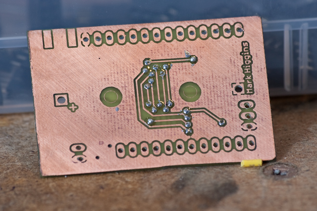

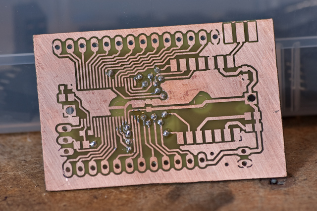

I know this is an old thread that has been bumped, but I've tried several methods. I tried the wire though method that's shown in the link and used it for a while, but it was never that easy or quick. The method I use now requires a hot air rework station unfortunately, but I just use a cheap Chinese one.
I drill the holes for the vias and lay the board flat on a piece of wood. I use a long piece of bare wire and insert it in a hole and snip it off flush. I skip through each hole doing this. The board is flush with the wood it's sitting on, so there's a small bit of loose wire in each hole. I put a dab of solder paste on each via and then just heat the board and the solder beads. Flip the board over, dab paste on the other side and repeat. It's super quick.
This was the first board I tried it on. I put a little too little paste on some of the holes so they don't look perfect, but it works well.
I have moved away from home etched PCB's but it was fun to do. My projects (quadcopter flight control boards) really require professionally fabricated boards but your technique is a good solution.
Thanks for sharing Mark.:)
