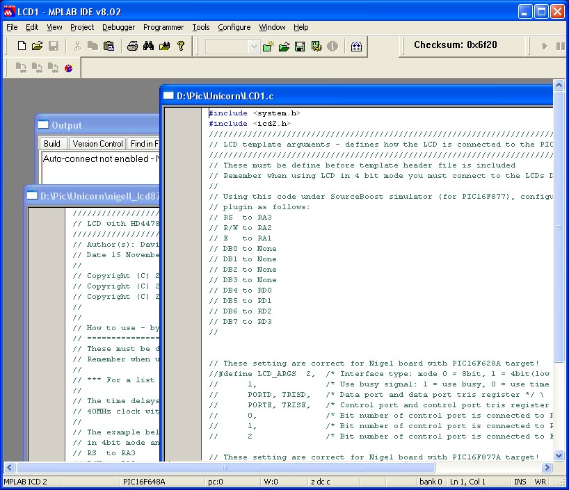

Screen shots
3v0,
As far as screen pictures / videos. If you are on windows, (I assume that is true) you may look at a freebe call HoverSnap. With it you can get a jpg of the current window, or choose your own portion of the screen, etc. It may be easier that doing videos and provide the same information.
Works good.
:D
An example
This is a snap of the "active" window of a MPLAB session squished down a bit.
capture1-23-2007-1-41-21-pm7-30-2007-7-48-12-am10-3-2007-11-35-03-am3-18-2008-2-43-52-pm-jpg.18046
  • Capture1-23-2007-1.41.21 PM7-30-2007-7.48.12 AM10-3-2007-11.35.03 AM3-18-2008-2.43.52 PM.jpg
