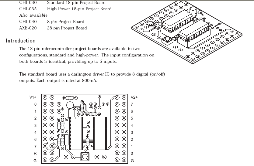

didnt know it was infra-red LED, as for the 50mA been alot for a microcontroller is that common for all?
my PIC can draw 800mA at any given output X8 is that common among PIC's?
It might be possible if the Vcc of the ATmega168 matched the forward voltage of the LED. It's still a reckless thing to do. What is the objection to using a resistor. A little bit of insurance goes a long way.
800mA per output? At 5V, that's 4W per output pin. Are you sure??

yep, have a look at the picture
Ahhhh, so now it is clear where your confusion is coming from. Your project board does indeed supply 800mA per output - via a darlington driver IC. The PIC itself is probably rated at 25mA per output.
Brian

yes i just confused the hell out of myself then, for a second there i was thinking that the PIC was outputing 500mA to my servo motor, but the power for the servo comes from a different supply, and i just use the output for the signal.
Ya shaneshane1, your Picaxe PIC is a 16F88. Standard max output per pin is 25ma.
