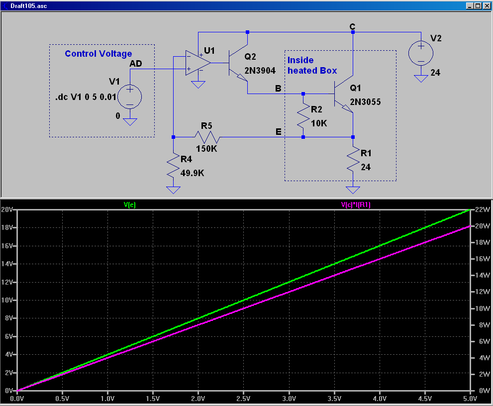

Here is a hack. If you put both Q1 and R1 inside the box, the power in the box is proportional to the A/D voltage; 5V in produces 20W.
R1 can be broken up into many resistors, such that the effective resistance is 24Ω, and the power rating is >25W. The 2n3055 (Q1) would have to be on a heatsink, AND inside the box.
The purple trace in the plot is the total power dissipation in the box vs A/D voltage (x-axis of the plot).

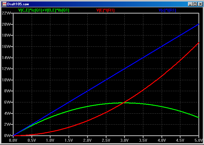

Your transistors will heat up A LOT. You could use PWM to control the current flow and not heat up the transistors so much.
Your transistors will heat up A LOT. ...
That is why I suggested putting it inside the box to be heated. :D
Actually, here is a plot of power dissipated by the transistor and the resistor(s) on the same scale vs the input control voltage. Note that the transistor dissipation (Green trace) peaks at about 6W, which is not a huge heatsink. The total dissipation inside the box (Blue trace) is linear, while the individual dissipations are not.
If you built the experiment into a aluminum project box that was placed inside a styrofoam beer cooler, the transistor can just be bolted to the aluminum box. The heater resistor(s) could be the kind with the screw-down flange, like these.

Thanks for your circuit, Mike
I have some questions, in your diagram, the UI represents the output of my analog device, right?
I don't understand what R4 and R5 is doing?
And V2 is powering the Q1 and Q2. Is that 24 Volts? I don't have 24 volt... how to deal with that?
Apart from that, thanks for the suggested transistor models!
U1 is an opamp that you will add to control the current through the heater.
V1 is the output of your A/D channel/
If you dont have a higher voltage power supply, will your 5V supply deliver ~4A?
