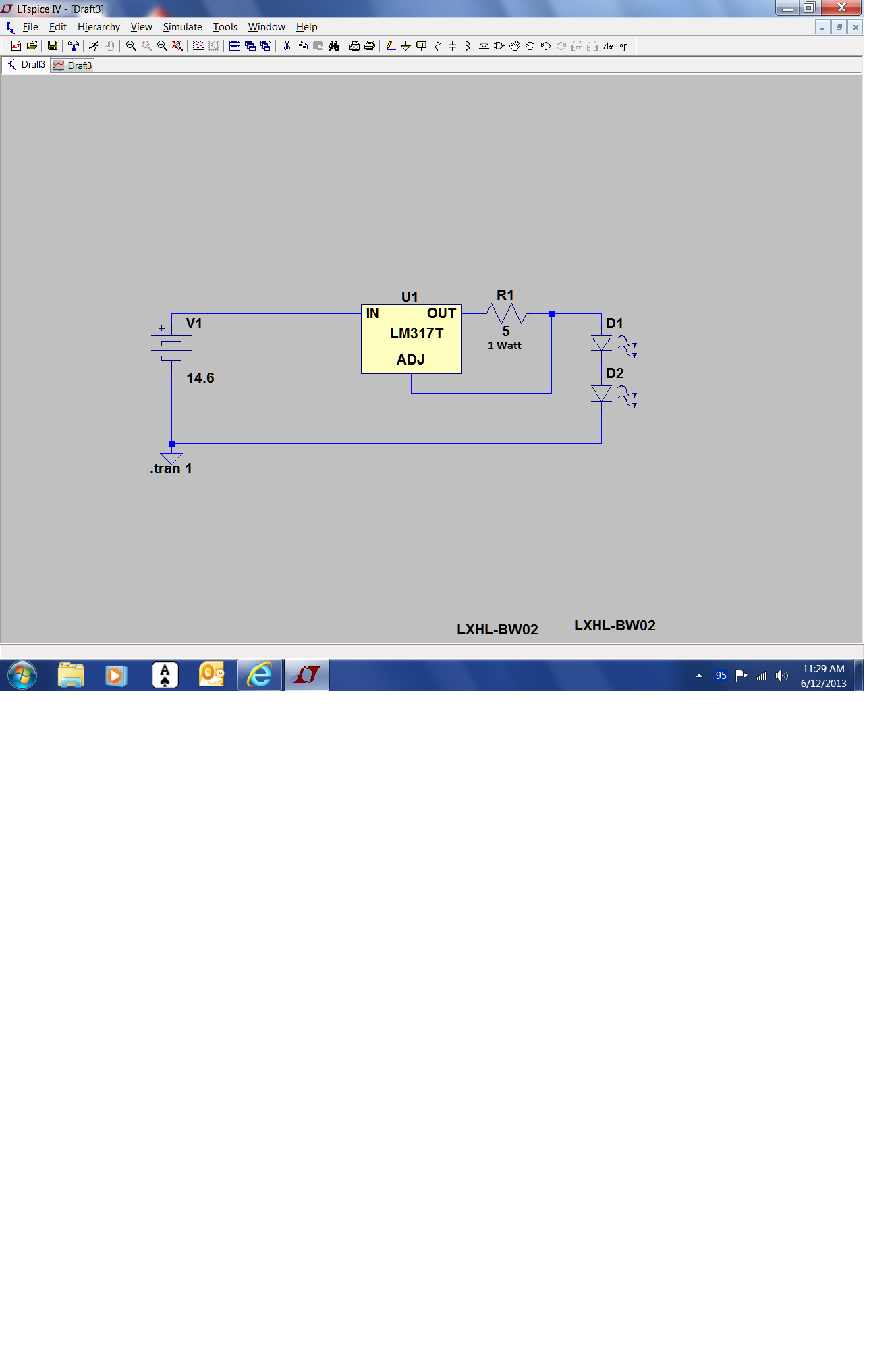

Constant Current Driver
Here is a circuit that is fairly easy and often used.
With the values shown it will drive 2 LEDs in series with about 260 ma. with a battery voltage of 12 to 14 volts.
This should work for your smaller heat sink, but we should look at a spec sheet to make sure.
If you are shopping radio shack the resistor could be 1/2 watt but it will be hot. The 317T should have one of your small heat sinks as well.

Thanks so much ronv, exactly what i was needing. I have had a read up about lm317's and constant current circuits with them in now i know what to look for, thanks. I am guessing the 5 beside the resistor stands for a 5 ohm resistor? New to the world of circuit diagrams!

Would 260ma be enough to drive them or would i need a different resistor to the one in your circuit? Or am I missing something? This was my thoughts:
I read that the resistor would be calculated by ohms law R = Vref / I. I take it from reading Reference voltage on a LM317 is 1.25V
So for 2x leds in series 700ma forward voltage R=1.25/0.7 which is 1.79ohms. So should i be using a 1.8 ohm resistor? If a 5 ohm resistor is used this would mean a current of 250ma, which is close to your 260ma figure?
Also i calculated wasted power (maybe if i am using the right values) P = (Vin – Vref – Vf) * I (13.5-1.25-8)x0.7=2.98W. Would my heatsinks be ok for this?
Thanks if you can help me again! Allan
Right you are.
Right again.;) I derated the current for the LEDs because they are only good for 700 ma at 25C. So that is with a huge heat sink. Since the LEDs will dissipate up to 1 watt (.25X4.2) they will be quite hot with your heat sink. I think they will still be pretty bright.
The total power will be 3.3 watts (13.5X.25) with 1 watt in the LEDs .3 in the resistor and the rest (2watts) in the regulator. It is hard to tell if 250 ma. is to much or if you could use more because there is no spec on the temperature rise of the LED vs. power, but my guess is they will be hot with 250 ma. and the small heat sink - maybe 50 or 75C. You can also see why the regulator will need a heat sink. I would try it with the lower current first.
Good luck with the project. Let us know how it works.

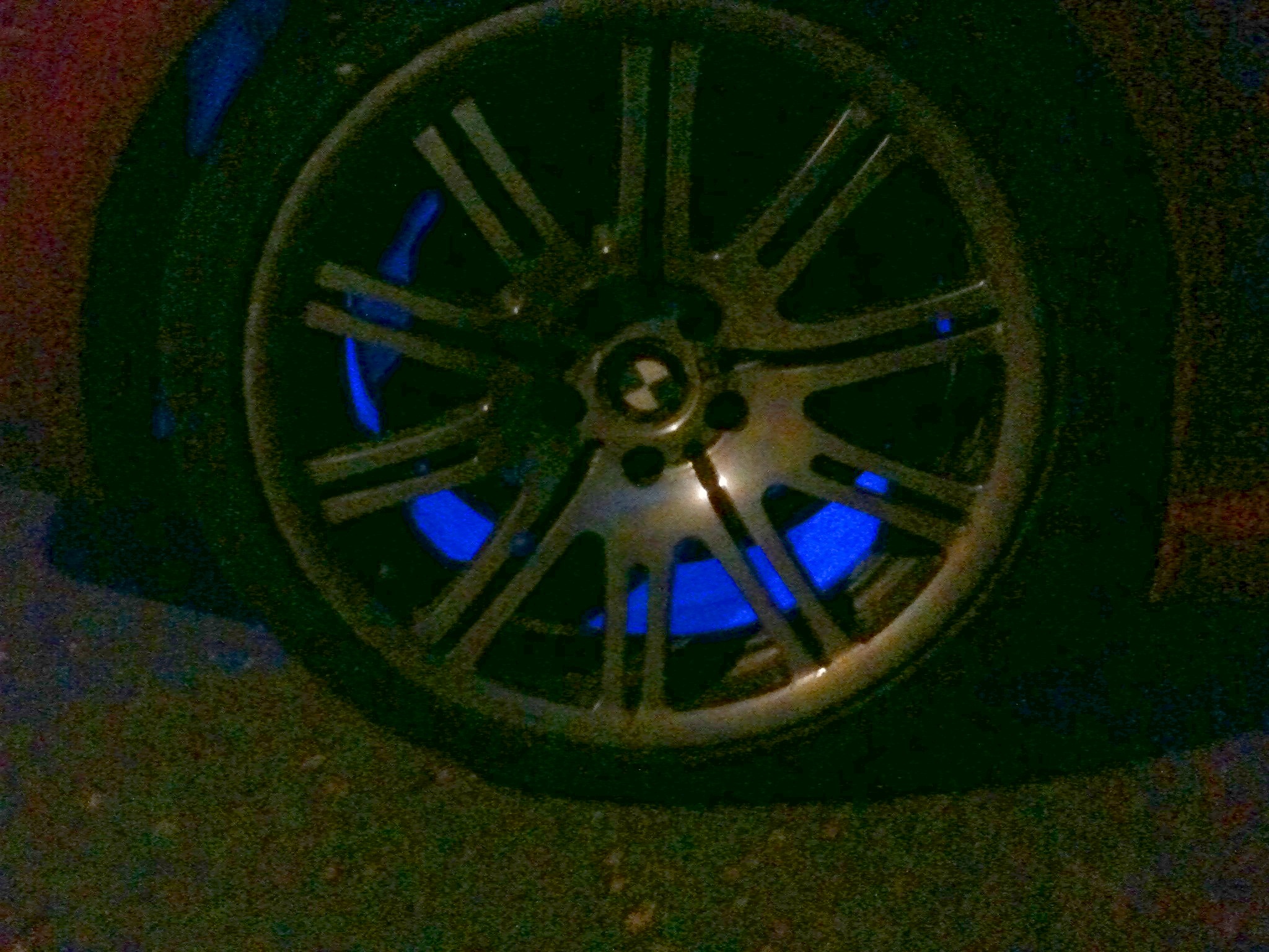

....but don't try driving them from the car's interior light circuit. You will almost certainly overload it and cause wiring damage or destroy the PWM circuitry which dims the light.
Ah ok thanks alec, yeah i never thought about that side of things with the higher power leds drawing more current. I had a circuit wired up directly but the leds weren't bright enough. However, i did the same thing on a previous car and it wasnt a problem- i had 3 smd leds in each wheel well, unsure of the ratings as they came in a waterproof block ready to accept 12V, and another wire running off the interior lights to 2x ccfl inverters in the headlights running ccfl rings. Now I think about it and have a little more understanding about electronics, the wiring must have been under a lot higher load. Still the dimming worked ok! Here is a pic of it before...photo.JPG
