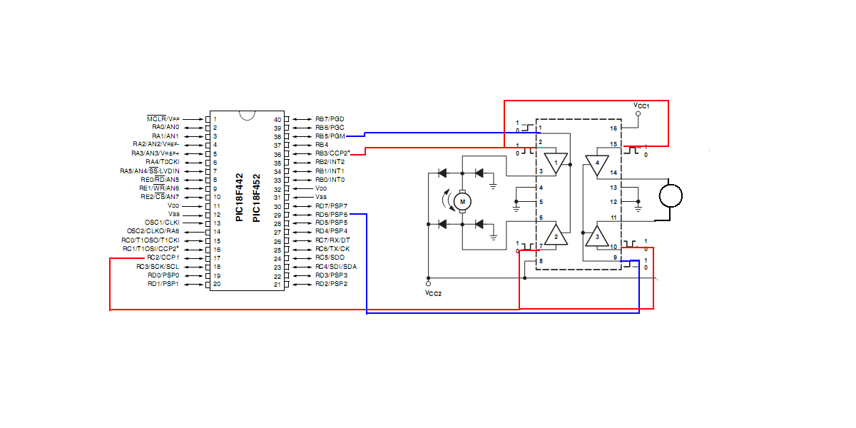

Can anyone guide me on how to drive two six volt DC motors using pic18f452? I know that it is possible to drive the motors using L293d. However, it is not clear to me how to control the speed of the motors?:confused: Can anyone please help? :eek:

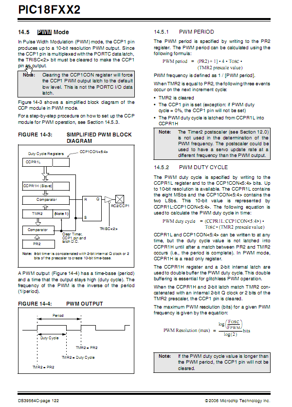

Get the datasheet from www.microchip.com
Extract:

Select motor? ..err..now I am really confused ...:confused:can you tell me which pins are supposed to be connected where more clearly..pls?:D
These are the pins:
PIC L293D
CCP1 ?
CCP2 ?
? enable
Thanks for the help again.Mate:)
The Enable pins can be of your choosing.
had a look at the pin connections.Looks a little diffrent. When I used the PLC to drive a 24 V DC brushless..one CCP pin was connected to to one motor. This connection is different as a CCP pin is connected to both motors.I have attached the programme. Take a look. I am still a beginner with PICs ..can u tell me ...how different will be the program for driving a motor with L 293 d, based on your pin connections?
I was thinking of connecting the directional pins on L 293 d to PIC pins and connecting CCP1 to left motor enable and CCP2 to right motor enable. That way,I can use one particular CCP pin for one motor. I think by connecting the CCP pins which generate PWM to the enable I could still control the motor speed. Because, I works like turning the motor on and off very fast which regulates the speed, which depends on the duty cycle...right???:confused:
I dont use 'C' programming so I cannot help with that program conversion.
The CCP1/2 and Enable sounds like it should work.
Its how long the ON period is, thats Pulse Width Modulation, that is the duty cycle of the pulse going to the motor.
