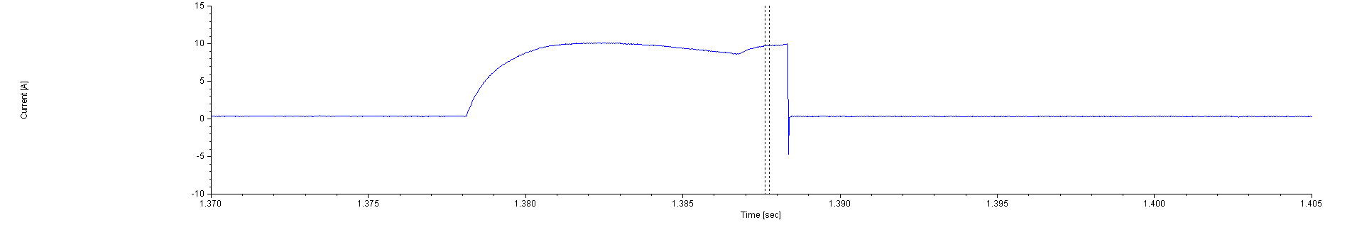

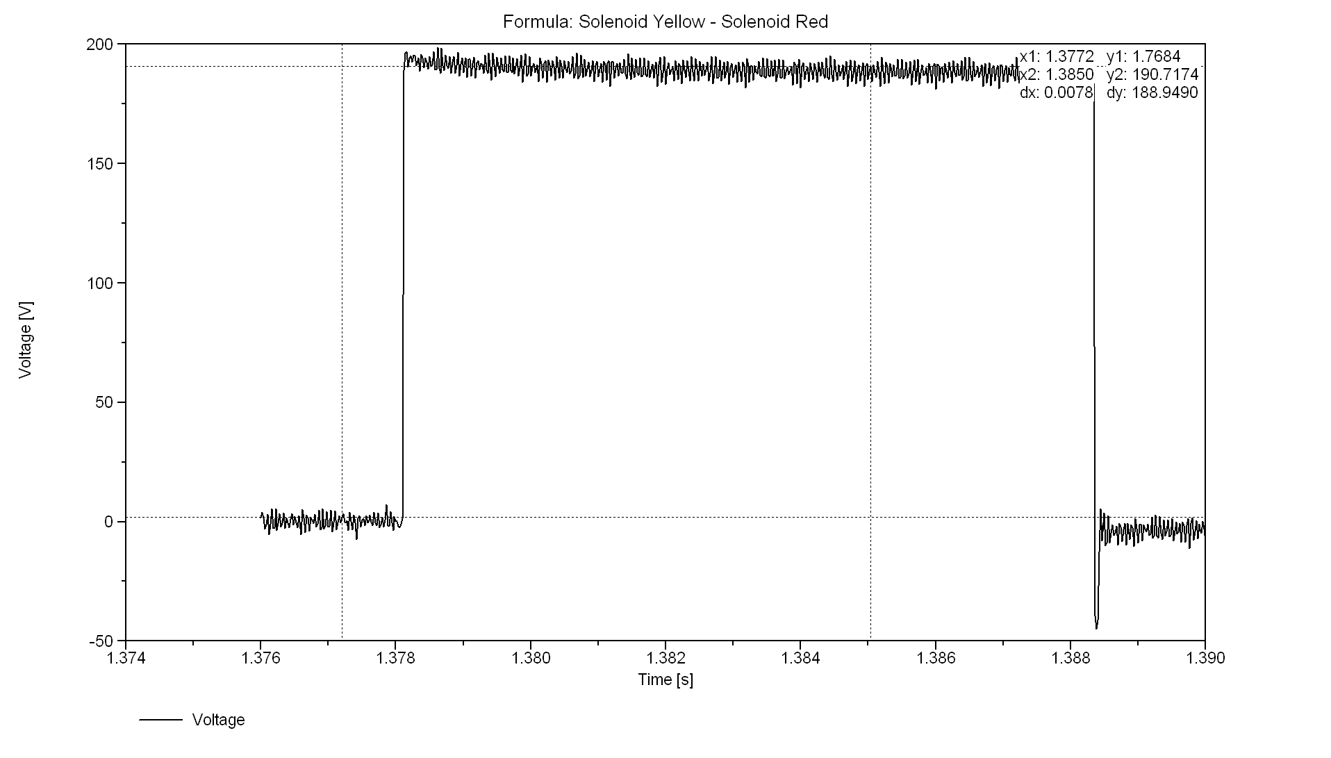

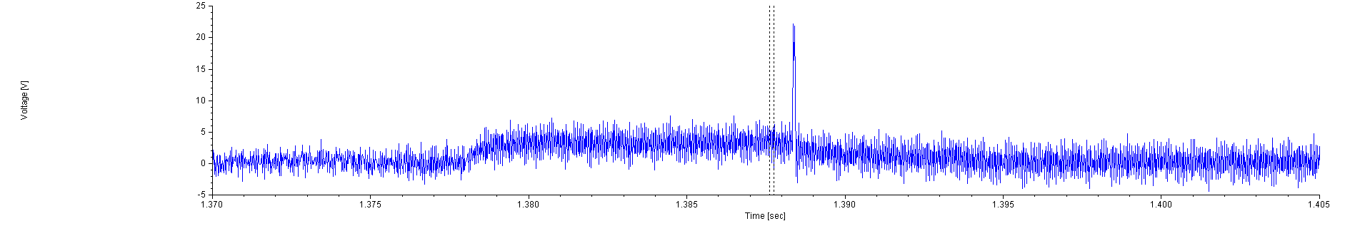

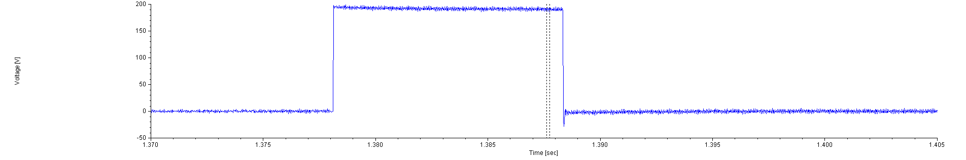

I've been scoping around and I've noticed that upon de-energizing the solenoid, I'm getting a current reversal, in the solenoid itself, and definitely on the power supply line as well.
The current reversal on the power line is worrisome. If my thinking is correct, the inductive kick is enough to push the V- above V+. Am I correct in thinking this is the only way the current reversal is possible? If the current was being measured inline with the solenoid, I'd expect to see current reversal, but definitely not from the power supply.
Attached are plots of the Voltages at the solenoid terminals (wrt to V-) and the power supply current (disregard the offset). These were recorded with a large High J 270V Varistor across the terminals of the Solenoid. Would it be better to connect the Varistors from the solenoid terminals to V-? I've got some transorbs now and will see if they make a difference.
It definitely looks like an inductive kickback issue.

The current reversal in the power supply is typical of the energy of the solenoid moving back into the power supply as per my previous explanation of how the diodes redirect the current after a transistor turns off. That's going to be normal. The thing to watch out for is that the impedance near the top of the bridge is low enough to handle that surge without having the voltage rise too much. The snubbers are there to protect the transistor mostly during the time it takes for the line inductance to settle, so they may not eat up all that surge but only part of it.
If there is significant current reversal in the solenoid it would seem that the opposite pair of transistors are turning on. Is there any way that would normally happen with the drive circuit?
There is no current reversal in the solenoid. The inductance just attempts to keep the current moving in the same direction. But this has the effect of reversing the voltage across the solenoid since it now goes from being a current sink (load) to being a current source.
Thus, if you have the solenoid energized by it being connected between the plus and minus supplies and then turn off the transistors, the solenoid will keep the current flowing for a short period by pulling current from the minus supply and pushing it into the positive supply through the transistor's free-wheeling diodes. The power supplies should have enough capacitance to absorb these current spikes. If not then you will get large positive voltage spikes on the positive power supply and negative spikes on the negative supply.
