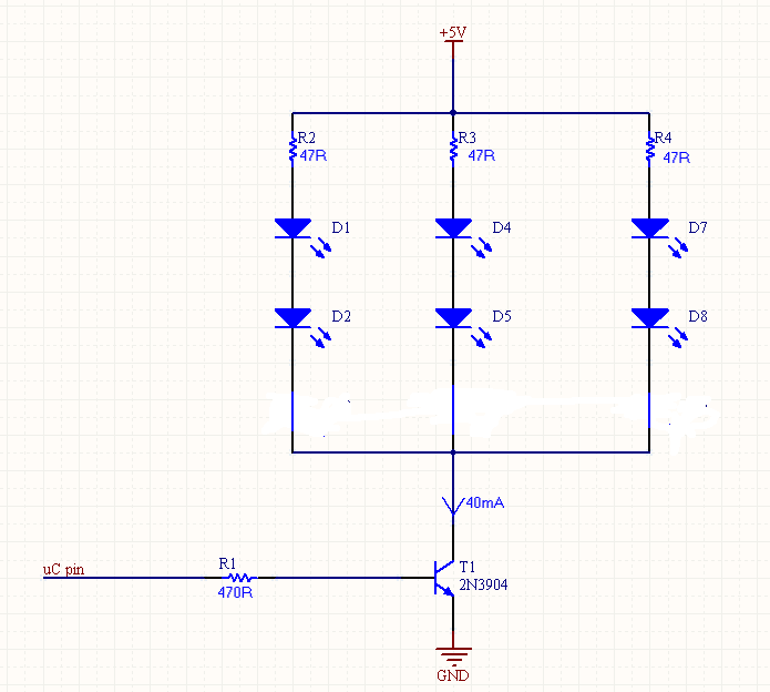

Repost of the way the DIL 5V relay is connected, the pin # are the relay.
Personally I would have just used a transistor to drive the LED's.
what about this one or any suggetion?
Looks OK, but you cannot drive three 2V Red LED's from 5Vdc supply.
Maximum is two, unless you use +12V, then it can be five 2V Red LED's.
OK.?:)

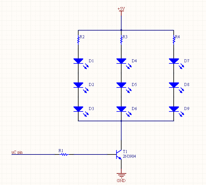

Attached dwg.
OK.?:)
Attached dwg.
i'm using 13V 800mA plug pack but when i put my multimeter probes just before 78L05 i measure something like 16.5...V. can i use it to drive the LEDs?
If the 16.5Vdc stays close to that value, you could connect 6 or 7 Red LED's in series with suitable resistor and drive them with the transistor.
eg: 16.5V - [7 * 2Vdp]/0.015mA
thats 16.5 -14 = 2.5/0.015,,, = 166R, say 180R.
OK.?
OK.?

Is 2N3904 the right part for this application?
The 2N3904 has a maximum rating of 200mA, but I would use it at not more than 100mA or so.
How much current will the transistor be switching.?
it'll be switching the circuit of 12V driving LEDs.
That dosn't tell me the current.:rolleyes:
So assume the RED LED's are 2Vdp/LED, as you are using a 12V supply, this gives 5 LED * 2v =10Vdp per chain.
If you have one chain with a LED current of 15mA, this means you have to drop 2V at 0.015.
So you require a 133R resistor [ 120R] per chain.
So the current per chain with a 120R would be 2V/120R = 17mA
Using a 2N3904 transistor you could have 6 chains, in parallel giving a total collector current of 100mA.
Do you follow.?:)
Do you follow.?:)

If you have 5 RED leds in each chain and have 6 chains, thats 6 *5 =30 LED's
Where does the 36 number come from.?:)
