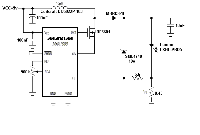

HI, i was wondering if anyone here has anyexperience in driving Luxeon LED's. Im using a LXHL-PRD5 LED with driving current of 700mA and forward voltage of 6.8V My main concern is finding the smallest possible constant current driver. I'll be using a single LED, emitter configuration. :lol: I hope you guys can help me out, thankx in advance!
What is the voltage of your power source? How much current can it supply? Is efficiency important, i.e., can you waste power, which means lower battery(?) life and more heat?

im currently starting with the design of the driver, then decide on the power circuitry, which means i can use A/C adaptor so i can have "unlimited" current.
so basically i desire less heat, no clause for power consumption, small circuitry, and more importantly, constant current, even at high temp.
with regards to power supply, i can adjust from 5-12V
i'll be using pic microcontroller to control some stuff --> i dont know if it is of any importance
im sorry if it sounds stupid since i am very new with hardware design, am a software/firmware designer but was task to do this so any help would be gretly appreciatedÜ

Here's another idea, which I took from this app note. It should provide 700ma drive, but you would need to test it carefully before driving an expensive LED. I would buy a 6.8v, 10 watt zener to test it on, such as NTE5181A.
Read the app note carefully. It explains the purpose of the 10 volt zener and how the resistors, transistor, Schottky diode, and inductor were chosen. I may have made mistakes. I haven't tested it or simulated it.

Just would like clarify that the vcc to use is 5V? the forward voltage of the prd5 is 6.8V, will this be able to drive the LED? thankx again.

Yes. In fact, VCC must be less than the output voltage, or I believe you'll get smoke from the diode and/or the inductor.
