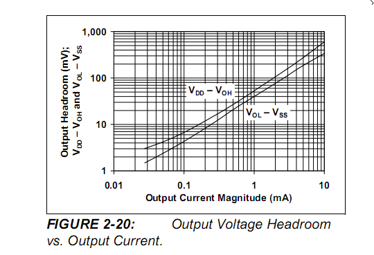

I would say you could have a problem getting down to 10mV, look at this clip from the d/sheet.
You could try as crutschow suggests to get the 10mV, but it may reduce the close to Vdd rail output.
Try it and it let us know.
E

I will have a look, but I worry that even if I can get down to 10mV on the mcp601 I have here.....what will the next batch be like?
I am not sinking any current into the mcp601 output, so from the graph Eric kindly provided, it does look like I can get down to 10mV...of course, I need it to be in the linear region at 10mV too.

It is a Cmos "rail-to-rail" opamp so of course the output goes to ground when it has no load or when its load connects to ground.
But the spec's and graph in the datasheet show the load connected to half the supply voltage (VL= VDD/2) which causes the output voltage swing to be reduced.
You have opamp U17 driving the inverting input of opamp U7 which is NOT a load to ground so the output of U17 cannot go to ground.
