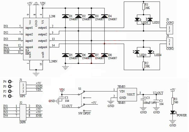

Below is the schematic of the circuit that I would be using, I bought a controller board already built. I can do the PWM with the pic as well, but I'll like to know how I would limit the current into the motor coils. A power resistor sounds like a quick option which I would be using at each output between the motor and L298, but what other option do I have. How would I implement this using a PMOSFET?

The simplest solution is to use an L297 along with the L298. That uses smaller resistors to sense the current, and to control it by turning the supply voltage on and off.
The diodes should be Schottky ones and should be rated to 2 Amps or more.
If you are using a power switching IC like the L298, there would be no reason to have some other power switching element like a PMOSFET.
I found this AN470 that has lots of info in it and I should be able to complete my design with it. I'll replace the diodes with schottky ones, that's just the way the board came in with those 4007
Yes the 1N4007 are to slow you need faster diodes otherwise the chip may keep blowing. I have used BYV27-200-TR witch is a Ultra Fast Avalanche Diode.
The current senses resisters go between the sens A and B pins and ground, Can you isolate those pins on your board?
I might need to cut the trace to then solder the sense resistor, but I don't think I will need to use the sense resistor if I provide the correct PWM unless it is really needed by the L297. I'll have to see how it will work both ways. But in the case i do need a sense resistor I think a 0.5Ohm 3W resistor will do since the stepper I have can handle 2A, basically there will be 1V across the resistor causing 2W of power. I was trying to avoid the bulky resistor as I'm trying to keep the board I'm going to design lowest profile possible, but I'll make some readings and see what I'll get.
