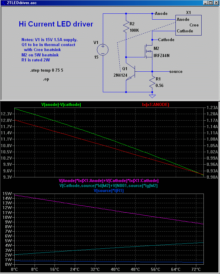

Here is a sim of your proposed driver.
All plots are vs temperature (most important thing is not to allow the Cree to go into thermal runaway)
Green is Cree voltage.
Red is Cree current.
Violet is Cree power dissipation.
Lt. Blue is M2 dissipation.
Dk. Blue is R1 dissipation.
Comments:
Take advantage of this circuit's rather poor thermal stability to automatically reduce the current through the Cree as the Cree heatsink temperature increases by attaching Q1 to the Cree heatsink (good thermal contact).
You need a 15V supply to provide enough headroom for the constant-current circuit to work. More than 15V will increase the dissipation in M2.
Almost any power NFET that meets the power requirements will work for M2.
Most critical component is the R1; it must be 0.56Ω +- 5%

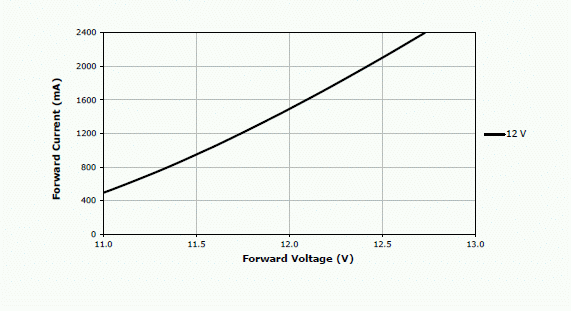

I didn't have a model of the Cree, so the one I created is approximate. I started from this: cree.gif
Wow, thanks for doing all that. I'm somewhat familiar with SPICE, but I didn't think of using it that way, by modeling the LED off the curve on the datasheet. So on top of doing the analysis for me you've taught me something I can use for future designs. Attaching Q1 to the heatsink is a cool idea, kind of a feedback loop. I'm also thinking I'll put in a thermal fuse just in case, not sure what temperature. It says the minimum solder temp is 100ºc, so probably something below that.

It sounds like 19V would probably waste some power and get Q2 warmer than needed. I'll see if I can get something closer to 15V.
Here is a running .asc file with the new model included. If you change the 2N4124 to something else, you need to resim...

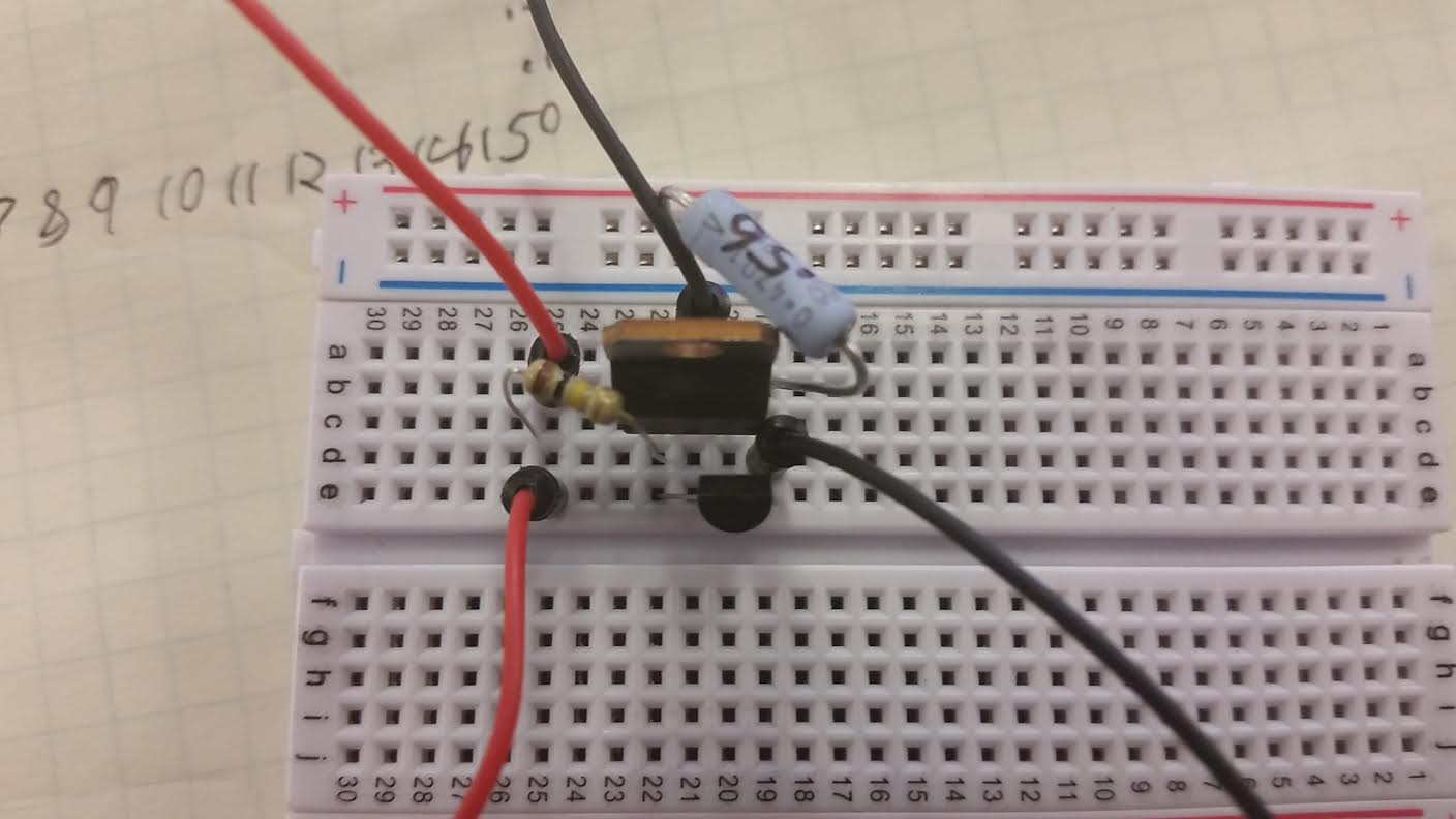

I built this test circuit on a breadboard. The wires from the bottom are the inputs, those going up are outputs. The blue resistor is 0.56 Ohm (marked as .47, but I measured several and found a .56), the other is the 100K.
The .56 goes from leg 1 of the BJT and Vin- to leg 3 of the MOSFET and leg 2 of the BJT. I know the circuit isn't readable from this picture, but it follows the schematic above.
To test it out without risking my LED, which I don't have yet anyway, I connected it to a 6.6 ohm 10W resistor for a load, and a variable power supply.
Results: It did provide a linear range. As I turned up the input voltage the current started to flow when I hit 4V at about 0.1A, it rose linearly till it hit 1.2A at 9V then leveled at close to 1.2A up to 15V. I didn't go higher than that because I didn't want to fry the MOSFET.
