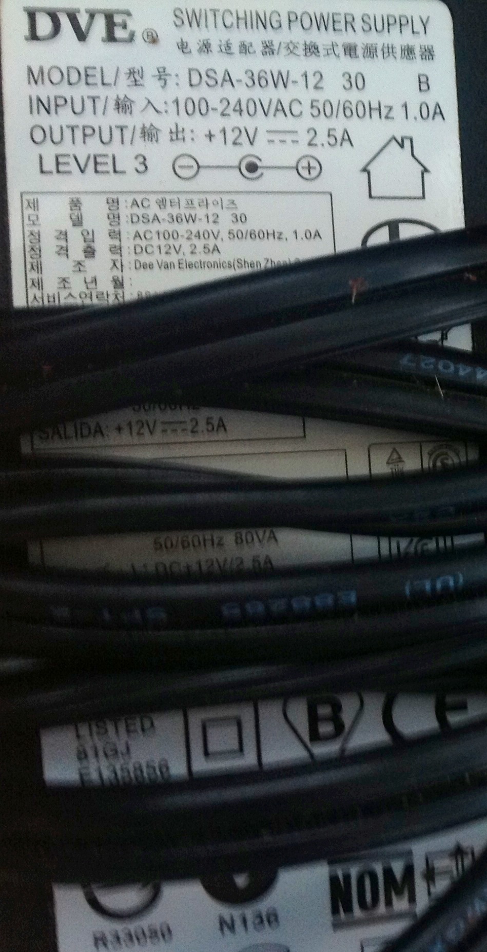

I wonder if I could tap into the projector to get a good supply. It has many voltages but I don't know which rails can support a 2.4A load without shutting down some other function. For example there is one that reads about 14.25V when the projector is on, but it seems to go to the motor that spins the color wheel. When I'm home I'll post some details about the projector power supply, it seems strange. Most of the projects I've read about where someone mods a projector have a ballast for the lamp and a totally separate supply for the electronics. Mine only has 120VAC come into the ballast, then 3 wires come out of the ballast into the secondary supply which then goes to the motherboard. There is no other path from external power to the motherboard. I checked the wires from ballast to the mobo power supply expecting them to just be passing the AC power from the wall - but no, they seem to carry 300V gnd, and -300V DC, then this supply puts out several lower DC voltages to the mobo. I feel like I must have made a mistake because this doesn't make much sense to me. Though I have been surprised before by methods that turn out to be common although they seem to be odd. Anyway, as I said I'll post pictures and more info on that, I'm sure there's no way for anyone here to tell what this projector is doing just from this, unless they happen to work with a lot of projectors.
For the most primitive ok design , one can use any regulated SMPS at 12.0V and add AWG 28 or 30 wire resistance to draw the exact current required, knowing how many mOhm per foot of hookup wire if long is OK.

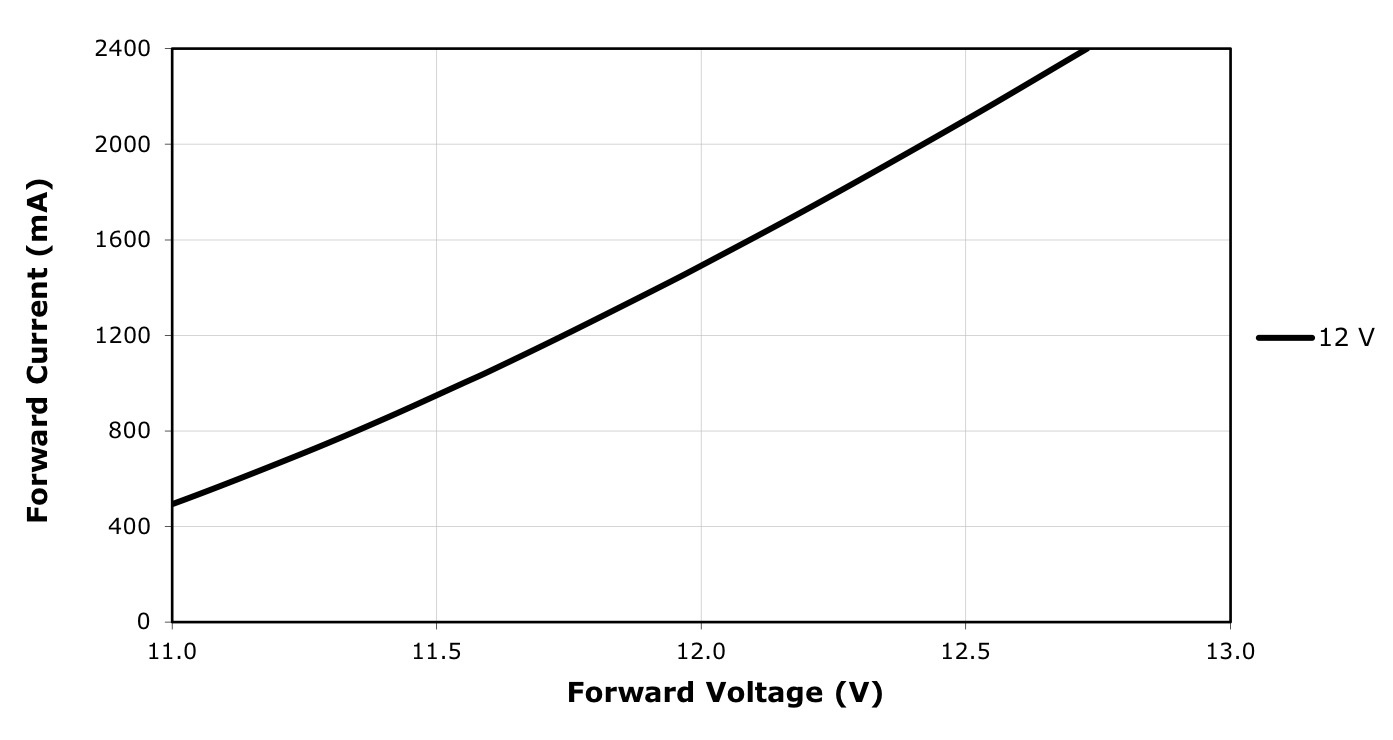

Forward voltage (12 V, @ 1050 mA, 85 °C)
Vf= 11.6 typ. 12.4 max.
So it is possible theoretically, you get the rejects of the 11.6 +/- 0.2 V bin not shown in datasheet, but available upon request, Default Vbin K in datasheet infers 12.4 max at 1050mA at 85'C

Note in the graph from the CREE datasheet at 85'C , and 2400 mA, Vf=12.7 ~ 12.75 and 12.5V , If=2100 mA, so ESR=ΔV/ΔI=0.25V/0.3A = 5/6 Ω
Since this is adding 5/6 Ω Fixed R @2.4A would be a 2V drop above 12.75 or 14.75 is a pretty non standard voltage,
I will retract my previous suggestion to run at 12W fixed V with Rs and instead run at 32W with a matched SMPS CC power supply for best efficiency and dim function.
